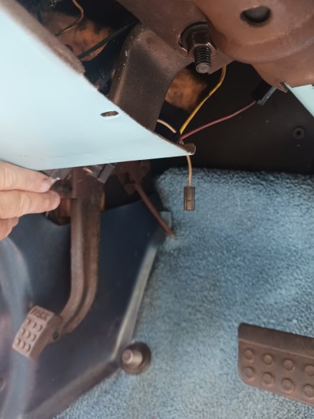

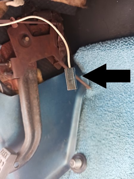

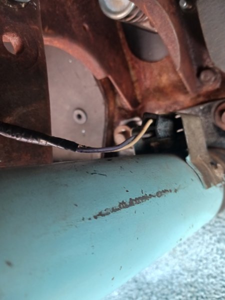

While I was playing with my turn signal switch wiring, I noticed that my Column mounted reverse light switch did not have the connector attached. I found it and plugged it in. But the lights did not come on when I put it in reverse. So I found the power wire also hanging under the dash, I jumped it with 12v power, put the column in reverse and VIOLA' the reverse lights came on. Looking underneath the dash I cannot find where this wire plugs into. Its a factory plastic covered female spade connector. I looked on the Light switch for an "accessory" spade to plug this wire into and theres nothing there. And I dont see any nearby loose wires where this plugs into. Does anyone know where it plugs into?
See pics

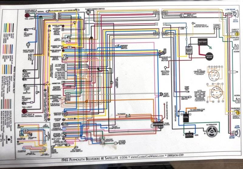

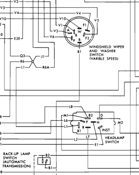

The white wire from the back-up, or reverse, light switch connects to the "B" terminal on the windshield wiper switch.
The following excerpt from the wiring diagram shows the connection. "B1" is the white wire.
very helpful, much appreciated. I have the single speed wiper switch (#2497282) but I see there is a spade on the switch that is not used when the harness connector plugs into the switch, that must be where the white reverse wire plugs into.
I think I have all the info needed to get this resolved, car is in the garage and its raining now. When it drys up ill take the car out and see if it works, but it makes sense, the back up lights need a switched power supply and it seems that the available spade on the wiper switch will provide it
