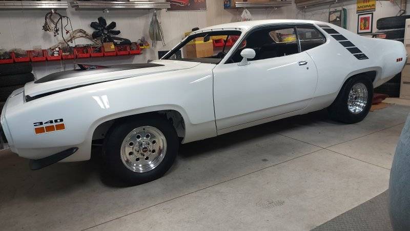

I believe this pic was from about 1977. Don’t think I did anything to it on suspension, just changed to wheels off of roadrunner. Did put a cb in it. Sorry no measurements. The lower trim piece seems to line up with center of wheel.
Vance.Dykes...I checked out the FSM (chassis), section 17. I'm not seeing anything regarding measurements. Tons of other good info though.
Wahya..thanks for the pic. This is where I feel like my car needs to be. Mine car does seem a bit sagged in the rear compared to yours.

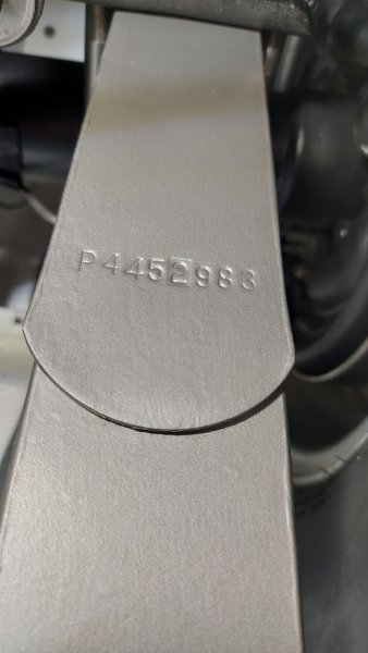

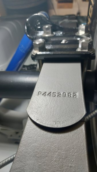

Here are the leaf springs I have on my 71 Runner.
Drivers side.

Passenger side.

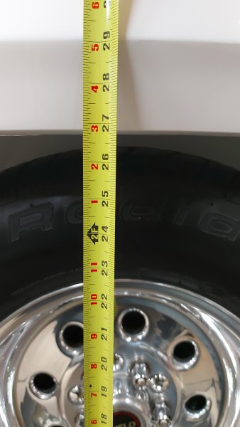

And here is a measurement from the floor to the rear wheel well opening.
Hopefully that will give you the info you need.
