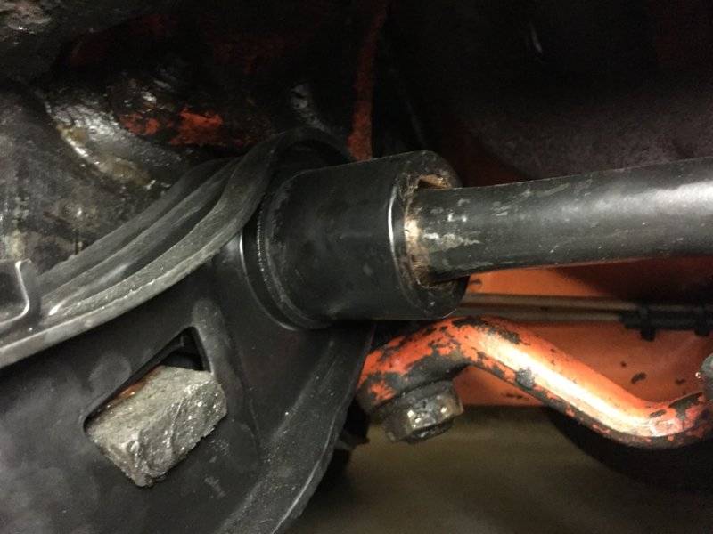

I had the same questions with my '69 Coronet as you have now, guess there will be not much difference in the parts and their installation.
With all components attached you can still remove/install the torsion bar, only thing i had to remove is the rubber bumper for the upper control arm to allow it to come a little lower.
With the ride height adjusting bolt backed all the way off the adjuster blade will sit just above it with a little play once the torsion bar is slided in it's socket.
If you would clock it 1 turn more you would not be able to get it in, or if you do get it in you will not be able to install the adjusting bolt and its bracket.
See in the picture, the adjuster blade sits flush inside the arm, with very minimal clearance between adjuster bolt and adjuster blade.

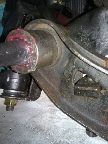

Well, that's my problem. My adjuster blade is sitting up high when I just popped out torsion bar. Gotta move it down and reinstall.

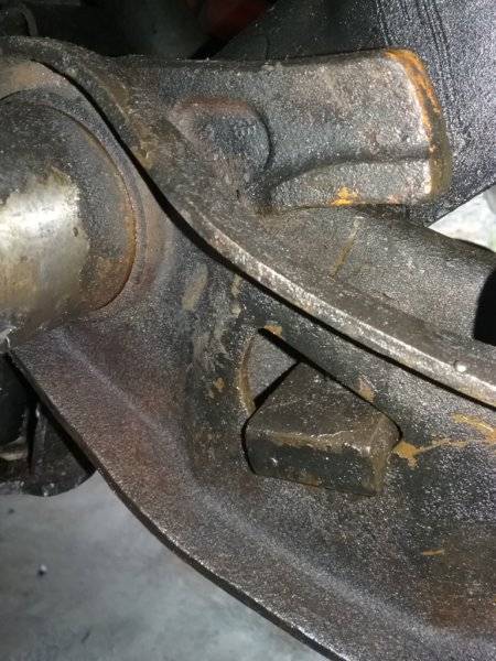

I think this looks better. I had to loosen the LCA pivot shaft nut to move blade down. (I know retighten to 145 LBs with weight on vehice). One side down, one to go. Thanks!
Yep, that looks good.
Loosening the pivot shaft nut can make it easier indeed, just to give it some play to wiggle it in and out as it lines up a bit tight!
