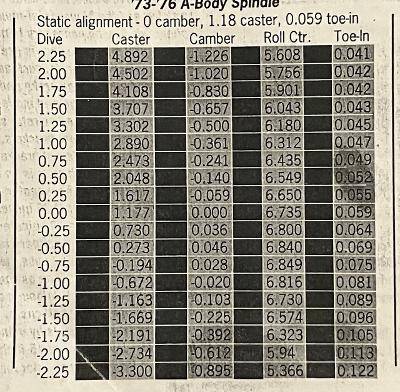

The front end alignment settings change a LOT when you lift or lower a car that much. Raising the car has a really bad effect on Caster especially. See the chart:
Going from 1.17 degrees of positive caster at a ZERO point (static ride height) to 2 1/4" higher, you go to 3.3 degrees of NEGATIVE caster. This plays hell with steering feel.
Now, if you're just looking to raise the car to push around a shop on smooth floors, those dollies are great. To drive on the street, The rise in height makes for a poor handling car.
You could get a set of those multi-adjustable upper control arms to allow you to raise the car and still obtain some caster. You will be limited as to how big a tire you can fit in the stock wheel openings.
