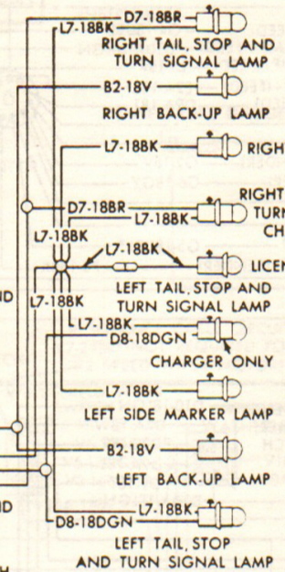

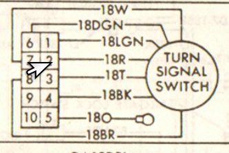

The ground and the wire must be good to the rear because the stop & turn element in the bulb are the same. It's a brown wire from the socket plug to the terminal 6 of the rear harness. That plug is behind the kick panel. From there it goes to terminal 8 of the directional signal switch connector (still brown). Looks like it's probably in the turn signal mechanism.
If it's stop only, and the tail and turn work properly, IT IS the turn signal switch.
You can easily confirm this. Probe the right rear TS wire coming out of the switch and going to the right rear. You should have both stop and turn power there. I'm betting "no stop" power. Remember, "stop" power is routed through the TS switch.
Crops of the diagrams right out of the book.
Left turn / stop is dark green, right side is red. So terminal no2 there at the TS column connector. Actually, LOL, I left the cursor there accidently.
