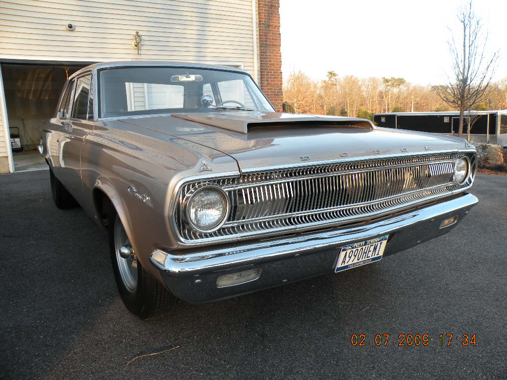

Very nice dodge !Well done.
Thanks, It was a very fun project where everything went pretty smoothly.Only thing I hated was the original single muffler exhaust system. Head pipe gaskets kept blowing out due to excessive backpressure.

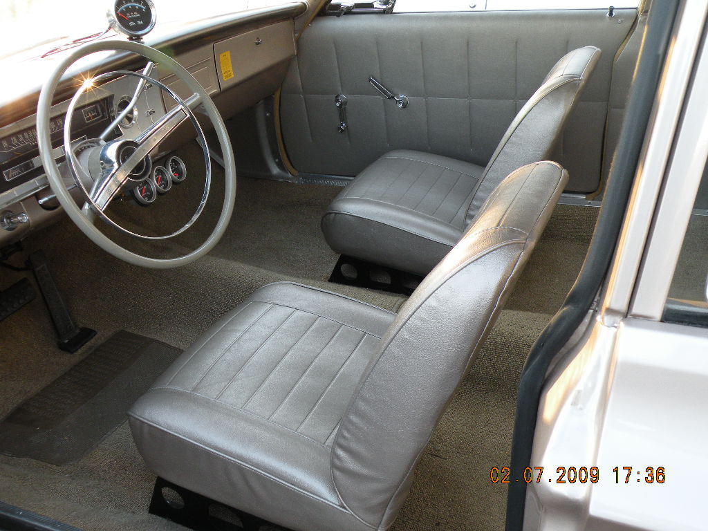

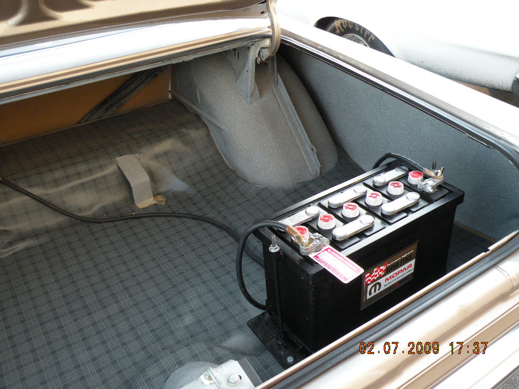

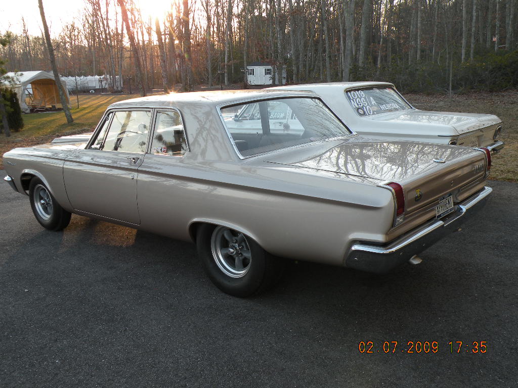

Chris, where did you get that repro battery? Also, where did you get the sticker on the glovebox door? That car is BEAUTIFUL!
