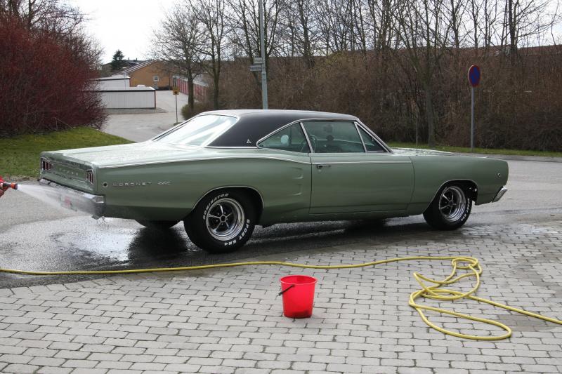

15 x 7 225/70 Front, 15 x 8 275/60 Rear

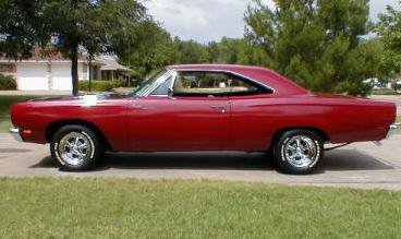

15 x 7 235/60 Front, 15 x 8 275/60 Rear. No rubbing

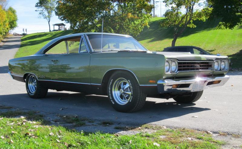

245/60R15 on 8" wheels with 2 1/2" backspacing in back. They don't rub, but it's real damn close without air in the shocks. Same size tires in front on 7" wheels.

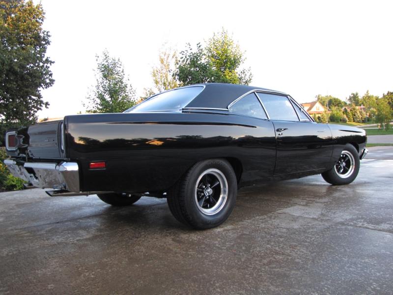

275R60/15 on 8" rear
235R70/15 on 7" front

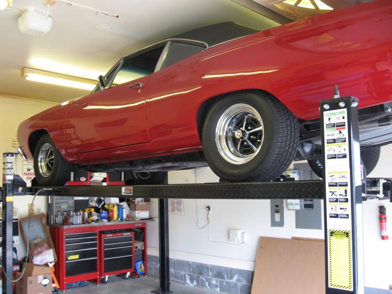

Will probably go 225R70/15 on the front next time.
