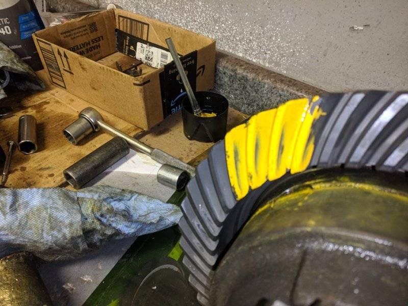

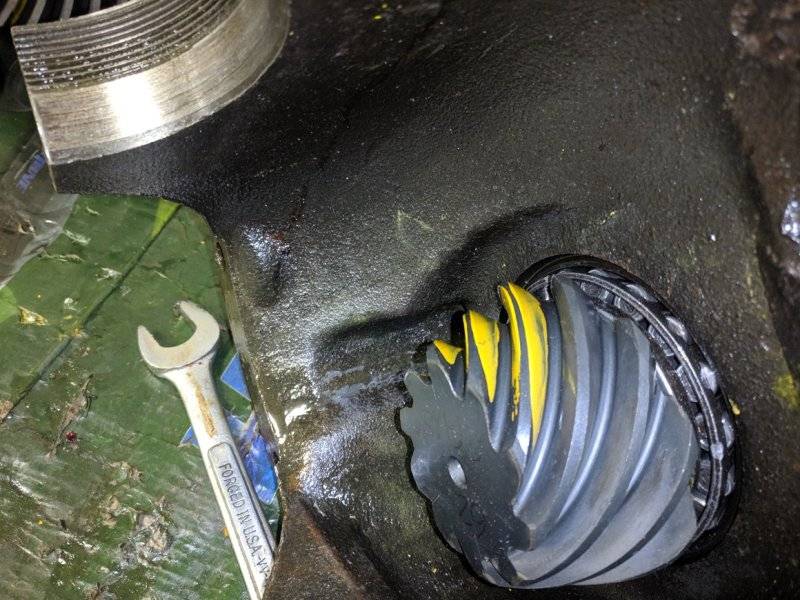

OK! Did a quick setup to see how it would come out, this is with .090 and .0075sh BL.. I look a little high on the crown on the ring and low in the root on the pinion, so if i am reading it correctly i should add a little shim maybe .095-.100.. I now get why Doug was asking for pinion pics.. you can really get a good idea of how the gears are meshing and the pinion seems more severe than the ring... it's way into the root area, will try to get it into the middle...
Now heres some fun bits... I think i found my runout issue.. where the 4.57 ring was mounted onto the carrier, the whole thing had a thick layer of red loctite, and i don't mean some dripped from bolts, it was COATED in loctite, i had to chip it out and then wire wheel to clean it up..

You are correct in your reading of the pattern. More pinion shim is needed. I'd add .010". if it's to deep then you can zero in instead of makiking .003" at a time a bunch of times. Earlier I thought you said you had a 489 case. Hence my pinion shim starting number and location in post 27. Since it's a 742 case .090" under the pinion was a good starting point.
