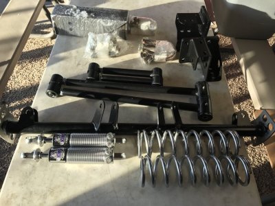

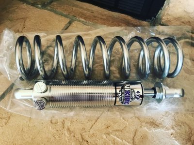

Got my street lynx kit delivered, I only took a picture of the shocks but I must say the whole kit looks to be top quality. Will post pics of the complete kit tomorrow when I go back to the shop.
You need a sway bar for a 4 link as well. Still the same premis as leaf springs. Still need to tie the suspension in with the body.
