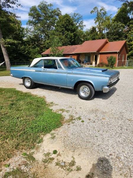

65 Coronet looking for a full set of shocks. Has a 440 based max wedge stage lll top end. 4.10 gears and ill probably go with some super stock springs. Car is mainly a street car but I will take it to the track next year for sure and want to be competitive. What shocks would you recommend for this combo. Would super stock springs be ok I need new ones .

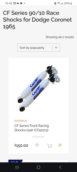

I have Competition Engineering adjustable drag shocks on my ‘69 GTX. They are set at 50/50 on the rear which is equipped with 3800# SS springs and an adjustable pinion snubber. Fronts are set at 90/10. I wouldn’t bomb a cloverleaf with this setup but it actually rides and drives pretty nice on the street.
Im leary on a 90/10 front shock on the street?
