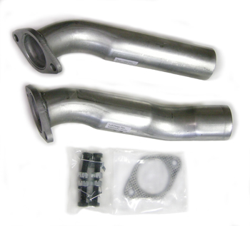

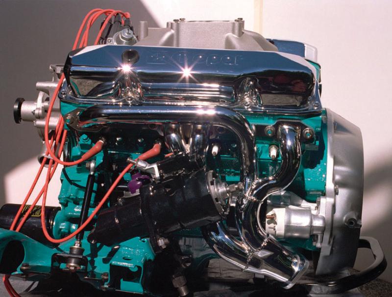

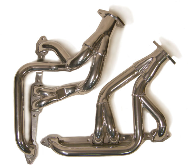

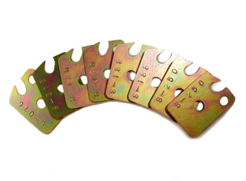

Here is some photos of Shumacher Tri-Y's they are great fitting but about $700 for Chrome... Also Hedman makes a good above frame "Semi shorty header" w/1-3/4" tube & 2-1/2" collectors shorty painted header $180+ semi cheap, also in ceramic coated "Elite" for like $400, that fits pretty damn well, "if your not racing they", they will flow much better than the stock manifolds with no reversion pulsing, "but' they are not as good as the long tube headers for overall HP/TQ #'s.... TTI's are also good fitting high quality "usually" for $600-$1200 good well fitting headers for a Mopar aren't cheap
