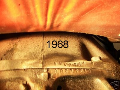

Welcome to the Madness !! Look on top of the block at the rear, near the oil pressure sender. A lot of 68's had a partial vin number stamped where the block meets the bell housing,
It's been a long time but I'm thinking my '68 had numbers on the bottom face of the block passenger side in front of the trans.
Are you thinking of the engine assembly numbers as opposed to the VIN numbers?
Pictured is an automatic transmission and associated VIN stamping for an automatic. The four speed should have the VIN stamped on a pad on the passenger's side.

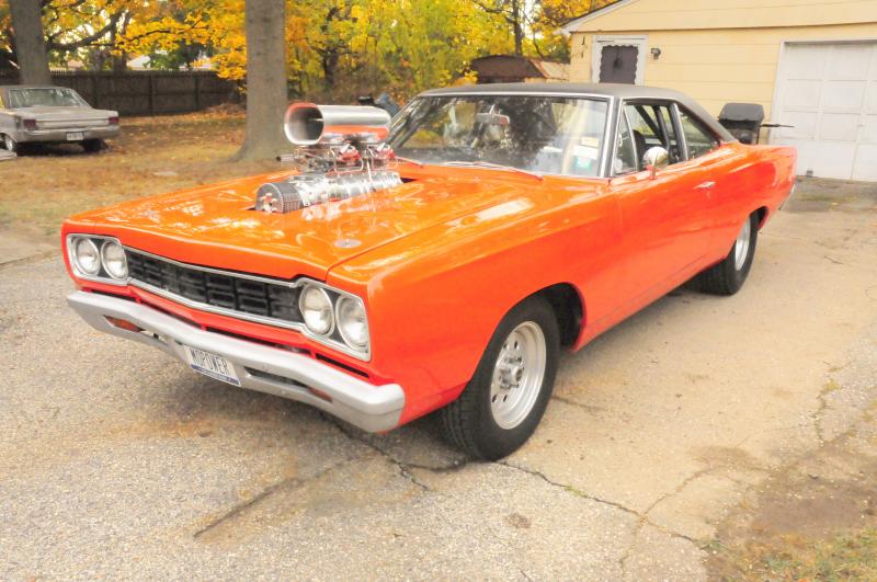

WELCOME FROM LONG ISLAND N.Y. 383 was standard for the 68 roadrunner .I think you could get a 383 or a hemi. mine was a 383 4 speed 8 3/4 before I made the decided to take it to the next level so to speak _DSC4818.jpg
That next level is sweet. I don't have the fender tag, but I do
