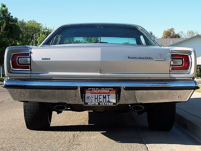

All good suggestions...prepare well and don't be afraid..AAA can DEFINITELY be a lifesaver for anything you might miss... *side note-An old friend drove his orig.68 hemi 'runner out here to cali years ago from the east coast...granted gas was much cheaper at the time, but in his only-a-salty-old-nam-vet way he always told me 'these damn things were built to be driven!' (original owner by the way) this is the only pic I have of it...
