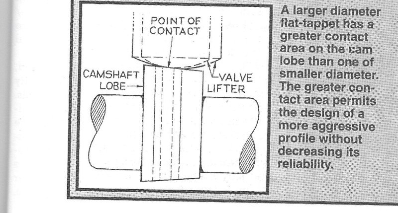

The LA cam lobes measured larger at the front edges of the lobes which means that the taper and the pressure on the lobes push the cam forward.
You’re 1/2 right.
On an LA, between each grouping of 4 lobes between the journals, the lobes taper in each direction 2 & 2.
