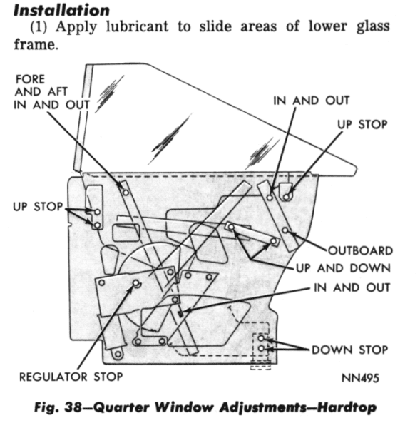

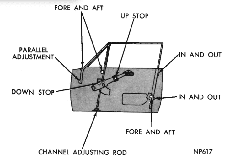

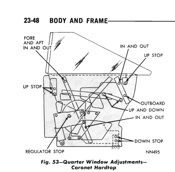

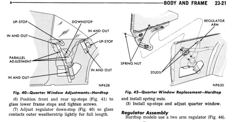

I will see what I can find.

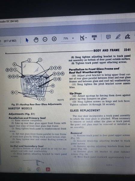

Great try, but it isn't the same as a roadrunner. Where the glass hangs over in the back, on the roadrunner it hangs over the front. I appreciate you looking. I went through the FSM for an hour and all I could find was the pic I posted. I wish this was the one because its labeled very simple. lol
Let me dig again.. Im sure I have it. But it was more for the reference of where the adjustments were. They can't be that different other than the glass.
