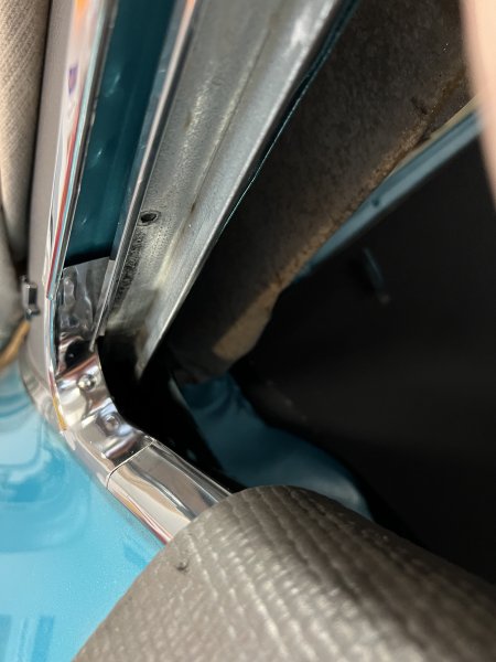

Hi
For the steel drip rail that mounts to the roof frame and above the glass windows
Once it’s screwed into place
What glue do u use to secure the wearther stripping. To track. And do u tape in in while
Curing or do u roll up the windows to hold it in place while curing
ROOF rail. Did you put the foam between body and roof rail ? There is no glue used to install the roof rail seal, it just locks in place.
Yes I replaced the seal between roof and rail. It was part of the paint set.
Thanks about the weatherstripping. Wasn’t sure about it
My original weather stripping is in great shape. Using that again. These repro never fit like the originals
