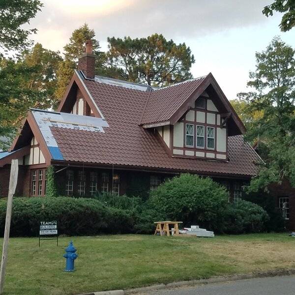

Quit your bellyaching' $75,000 for our project. It did include some extras. It took a crew of 6 3+ weeks to complete.
We recycled/repurposed 40,000# of the 99 year old original clay tile. It was crated and transported to Chicago.

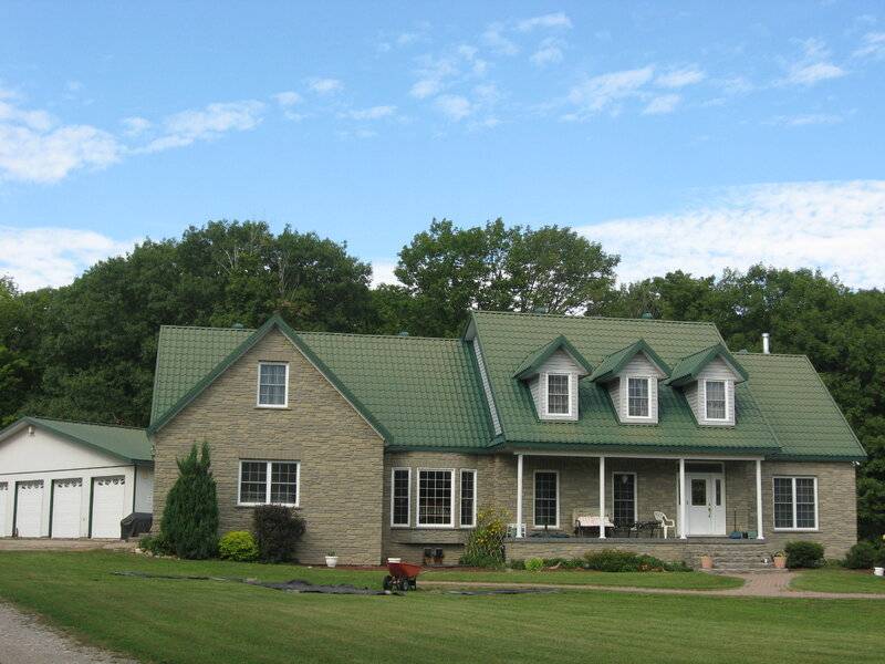

Mine was $26,000 in 1995... and my plan was it's to cover my lifetime! Need to get up there in the man lift and give it a good wash, and hope that's it. No leaks!

Is that Certainteed Matterhorn? Looks very nice!

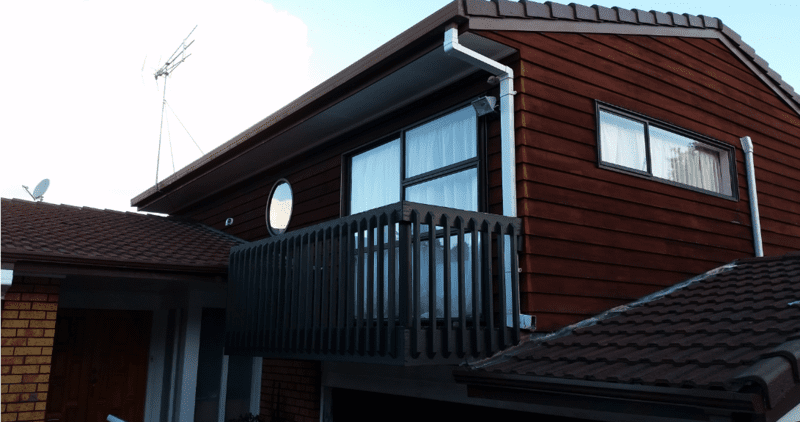

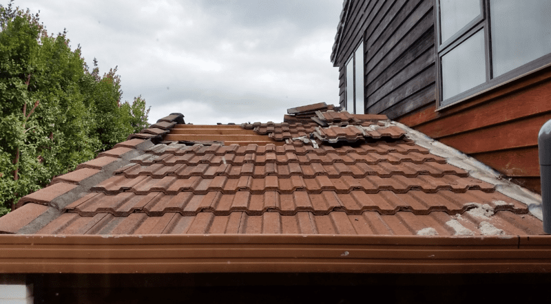

It's been just over 2 years now since our roof was repaired. Concrete tiles, traditional in this neck of the woods. The tile on our roof is a two-year only style (like a B-Body car), so it took a few months for the replacements to be sourced. Once the guys started, it only took around 3 weeks. All broken tiles were replaced, all mortar joints removed and re-applied (including ridges and hips) and then the entire roof was treated for moss & mould, then pressure washed and eventually re-coated - a better colour.
Originally a Spanish Orange, now we have a much nice "Grey Friars". We still get good comments about how much nicer it looks. At the time the cost seemed steep, but unless you're prepared to get off your butt and help, or DIY, it's a case of suck it up and pay the man.

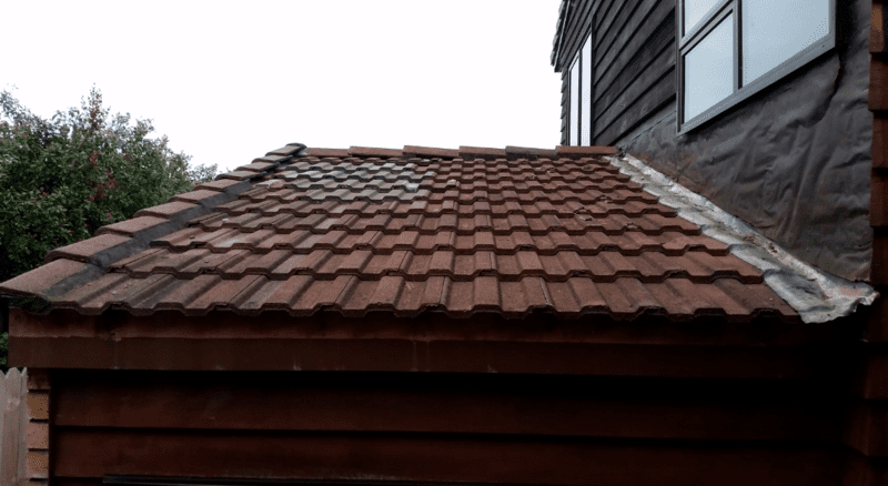

I also had to replace the lower cedar boards and replace all the lead flashings - as they had shrunk and torn over the years due to poor installation when the house was built in 1983. The trend then was to only have a 2" upturn on the edges, and run in one piece. Now the code calls for minimum of 5" upturn and maximum of 6' in a run (converted roughly from metric) :D The results are really noticeable. I waited for about 6 months after the worst part was repaired before lining the ceiling downstairs....just checking for any sign of leaks during our winter.
For the cost of around $14,000 here, I am more than happy with the job, as I no longer have any issues with the roof holding out the rain.
BEFORE:
Removed old wood burning fireplace....

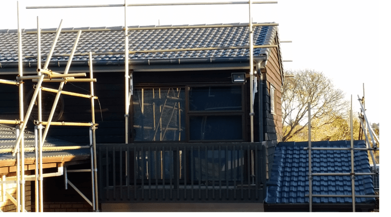

DURING:
The Scaffold crew were a bit rough in places....
By supplying the lead flashing myself, I saved around $1,000 off the cost. Luckily at the time, I was repairing a machine at the factory where the stuff is made.

WoW! That roof has to weigh eight tons! A metal roof wouldn't be cheaper/better for the climate?
Nice pattern though.
Not sure how much it weighs....but it is very stable...and is quite normal in this country. :)
I guess the truss network is different from your construction methods. The downfall of the concrete roof is the ingress of moisture and blistering heat. The reason we had the work done was to repair the broken tiles, and prevent further damage. When the coating/glazing is worn away after many years of weathering, the concrete is exposed, and takes on water/moisture. That makes the roof heavier and more prone to cracking if the roof freezes during winter...or blowing apart in the summer heat (a bit dramatic) ...so by re-sealing the concrete, the moisture is blocked. Most people don't consider that, and sadly that leads to entire roof replacement eventually.

My clay tile weighed 40,000# The semi driver that hauled them away was worried about being overweight.
