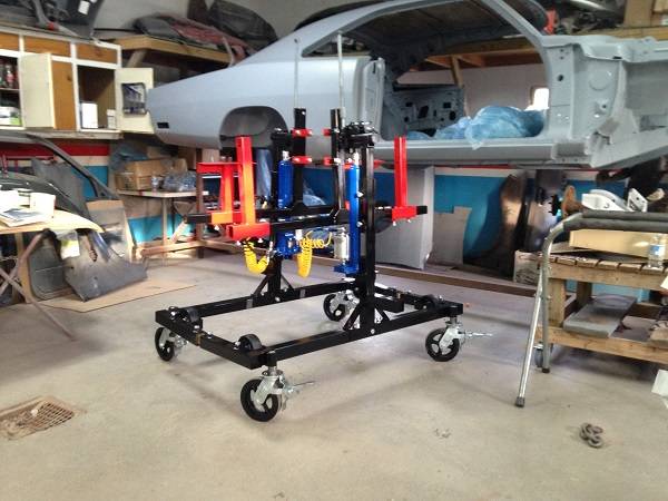

I agree Wayne. Man he does nice work! And those welds. Very clean and well thought out. I drove up to pick mine up. But I don't think Kevin would care to go for that long of a cruise. He does do a nice job wrapping them up for shipment though. When I was there he had one on a pallet ready to go.
Here is a picture of Stan's work all painted up. In storage mod.
I gave those KMS a good look and passed. To much Chinesium to have my Charger twirling around on.
I talked to Stan and got a quote. Good price and clearly quality.

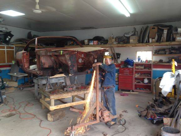

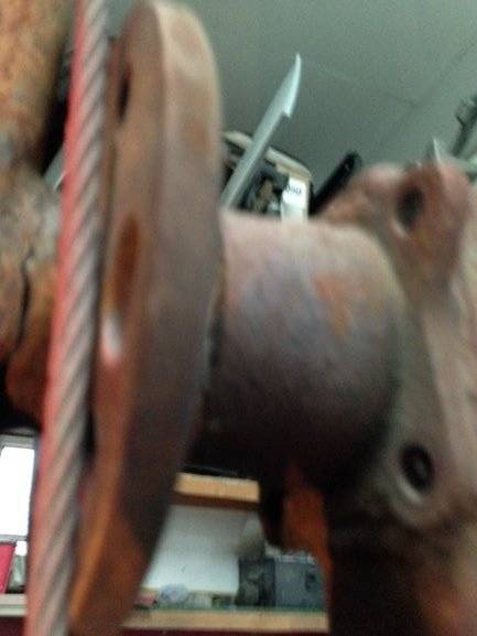

Cheapness is not always a good way to go. The first rotisseri my car was on just about went to the ground because of poor construction, and no ability to balance the car. Oh I know there is lots of them out there. After we mounted my car the first time on the "home made" rotisseri. We were all standing there admiring what a fine job we did getting her up there. Then all of a sudden we heard a load SNAP!
Like I said she wasn't balanced(and couldn't be) and the weld had to give where the tension was on it. Thank GOD the top weld did the trick to hold her there until we supported her and rewelded the axis point. My 23000 miler hanging by a thread.
Once we welded her up she was ok because just like our budget. She balanced herself. lol
Hated to hijack your thread Kevin. Just wanted to let you know what could happen to our priceless treasures.
I was so so lucky. Everybody wonders why I go to church! lol

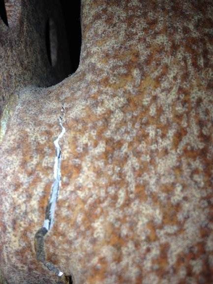

View attachment 888037 View attachment 888038 View attachment 888039
Looks to me like the me like the metal you used was ‘used’ and clearly fatigued, cracked and rusted prior to the snap. It didn’t break on the weld. One has to wonder if this would have happened if you used new metal.?
