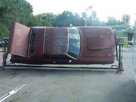

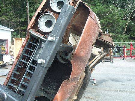

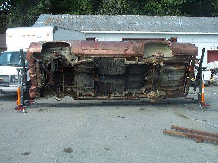

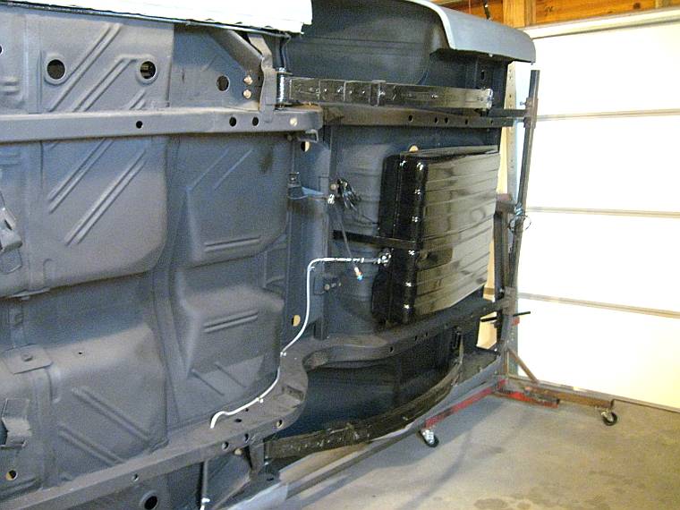

I made my own rotisserie out of a couple old engine stands and some 2" square tubing. The rear mount was just 2" tubing mounted to the rear bumper bracket holes in the frame rails. Very strong and held just fine.

Did you use longer bolts and go through both walls of the tubing or did you drill a bigger hole on the outside and use the existing bolts to only bolt one side of the tubing up to it? I'm guessing longer bolts but figured I better ask.
Used longer bolts and went through both sides of the 2" tubing and through the frame rail using two existing holes where the bumper brackets mount on each side.

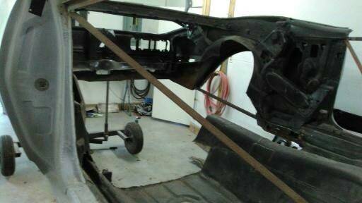

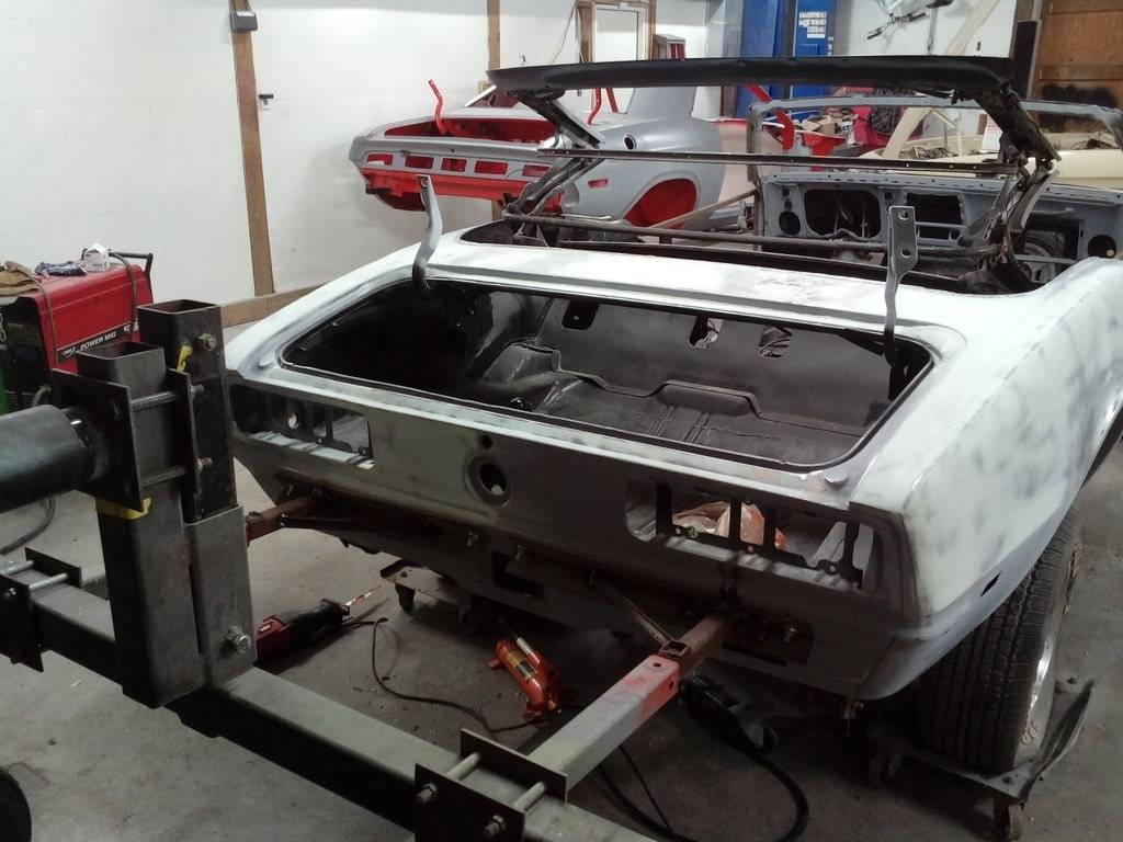

I have a not so good picture. But you can see the rear brackets. I also used the rear bumper bracket bolt holes for my rotisserie. I've had numerous cars on like that, never an issue.
I also built my 6 point bar while my car was on the rotisserie. When the car was all together and I reinstalled my door bars, the pins dropped in the same as when it was hanging on the rotisserie. Point is that nothing moved between being on the rotisserie and car back together and on it's wheels.

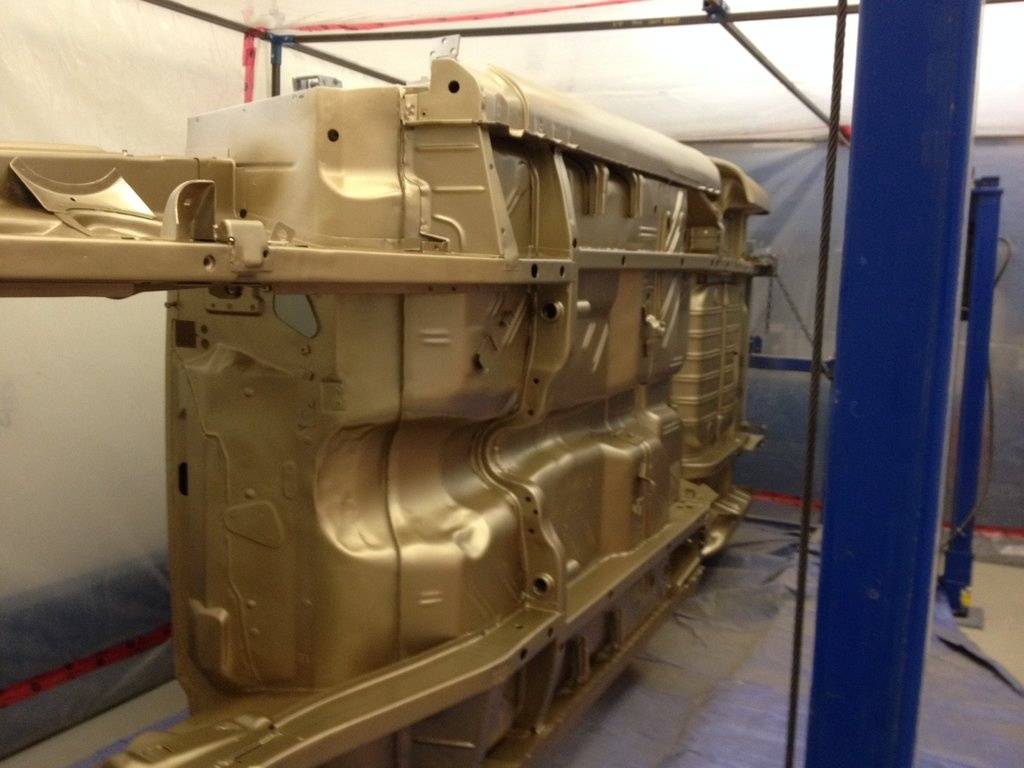

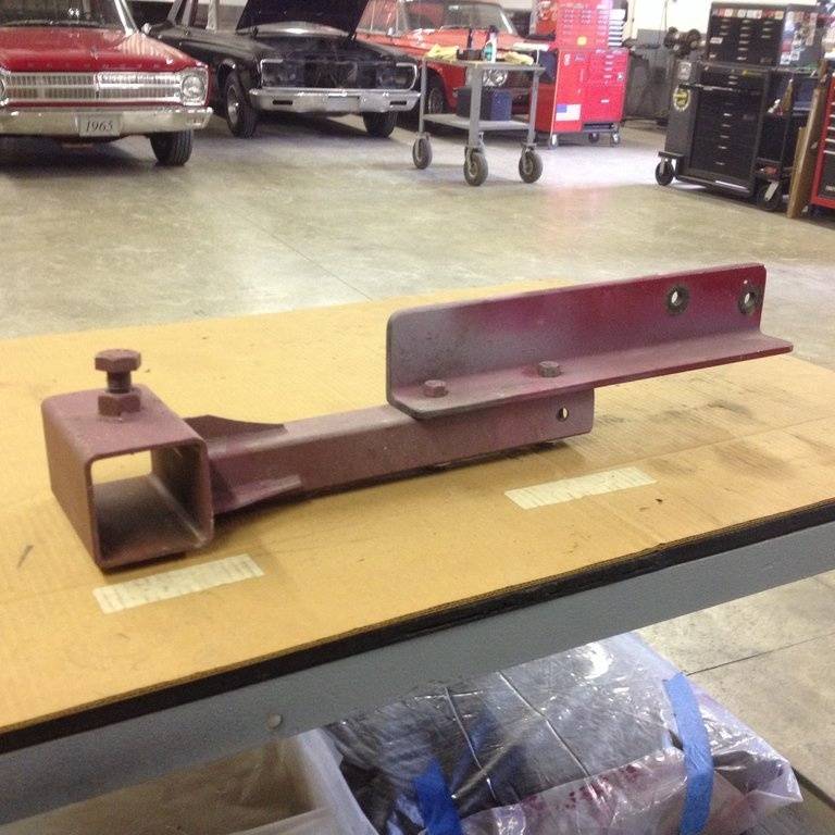

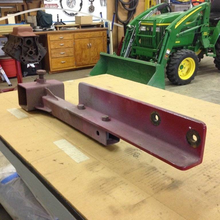

Sorry it took so long to get these posted, I've been too busy to get out to the shop. These bolt up to the bumper bracket holes. Note that the holes are offset . Hope this helps.

Very helpful. Did you run into any issues with the body being that far away from the pivot point? It just seems to me that would be a lot of leverage, but then again I don't know how much the stripped shell weighs. I just don't want to run into any issues with it turning. The one I have actually has a gear setup so you swivel it with a hand crank.
If I remember right, there was about a foot between the bumper splash shield and the pivot. Gave me room to work on the back of the car. Depending on the type of rotisserie, could be more or less. Mine is an Auto Twirler that I've had for 15 or so years. After installing everything underneath, lines, tank, exhaust, rear axle, I set the body down over the engine, trans, k-member and front suspension, I put the wheels on and took off the rotisserie. That was without interior, glass, doors, hood, fenders, trunk lid...etc. Total load, maybe a couple thousand pounds. Before installing the eng/trans, you could rotate it with one finger. Just keep the load centered, should be no problem.

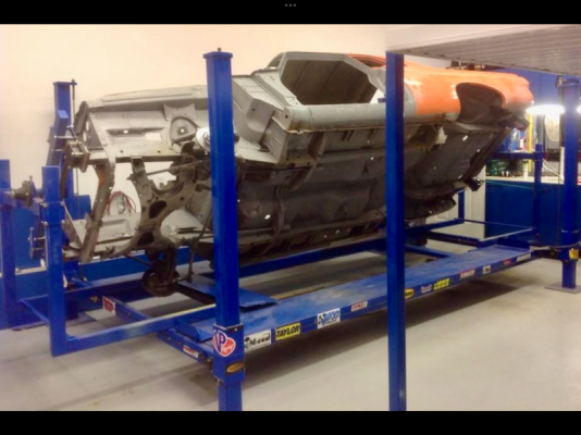

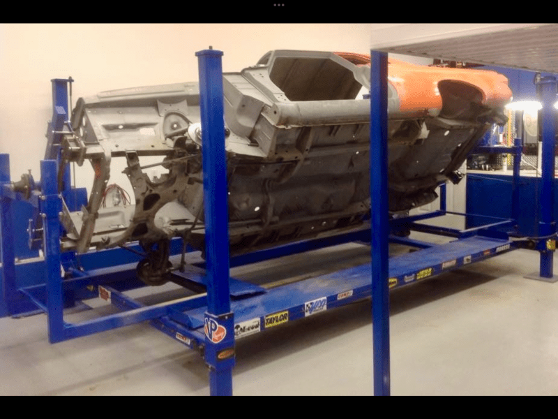

Looks great how tall is the main beam? Im making one for my 68 superbee so its make a full rotation thanks
The rotisserie that I built attached to my 4-post hoist. I made it height adjustable. I usually set b bodies at 42” or more.
69 SuperBee
68 GTX
64Plymouth
68 Dart - had that one set at 48”
