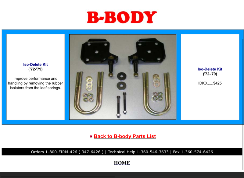

Firm feel sells a kit to delete them for 72-79
So, firm feel sells reproductions of the original 72 & earlier design spring plates... Call it an ISO Delete kit & charge $425..... Yeah... Pass...
Don’t shoot the messenger. Maybe there is something more to them than that. Will 73 springs fit on the 72 plate or do you have to use all 72 parts?
You can use either... Te difference is the locator bolt which Firm Feel includes.. But they are easily sourced for a few $$$ so that don't justify the price..
