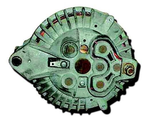

Trying to figure out what alternator I have here. Looks to be a re-man unit. Has this been converted to dual field? The 9:00 field terminal is grounded to the case under the wire clip.
This alternator came off my '68 Coronet when I converted it to EFI and was replaced with a modern Denso alternator. Before the EFI conversion, the car was running a Pertronix ignition dual-point conversion. It was being used with a Wells VR706 regulator. Seemed to work OK.

That's a 70/71 alt. Round back dual field. Hard to come by latelly. 72 become on square backs
Grounded to make it work as a single field.

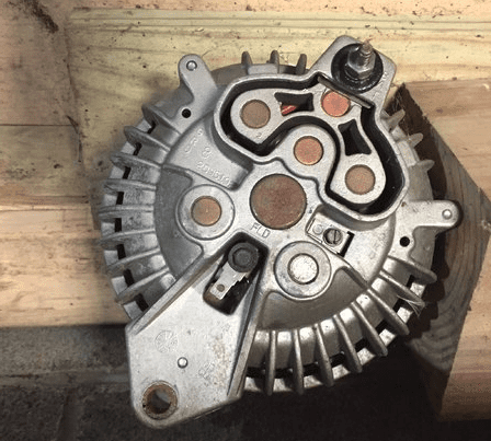

Original single field roundbacks ( pre 70 ) look like this
note the grounded brush on opposite side, without the isolator, attached straight to the case

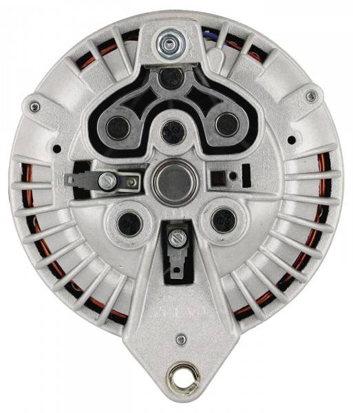

Some alts were disposed to accept both setups... note this case
So If the alt was to be installed on an older single field setup, the isolated brush was replaced for a non isolated brush on the opposite provision
Single field round back alts can be also converted in dual field just drilling a couple of holes to provide the location for the other isolated brush assembly ( and its attaching screw )

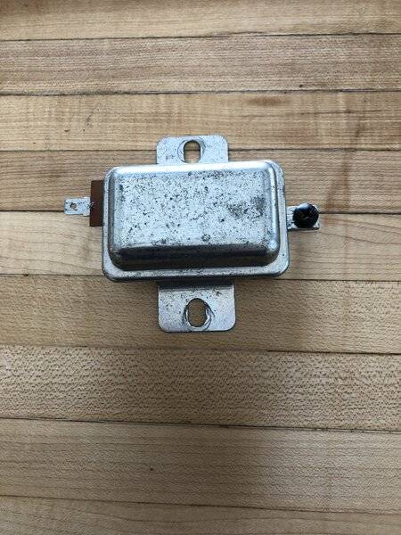

Thanks. This is the regulator we will be using, Wells VR706 which is what most people use when dealing with the pre-'69 type of setup. Same exterior connections as the mechanical but electronic inside.
Frankly, I kinda don't want to get involved with changing to dual field. I know it's a pretty straightforward exercise and I even have a few flat style regulators already but this project needs to kept as simple as possible.
