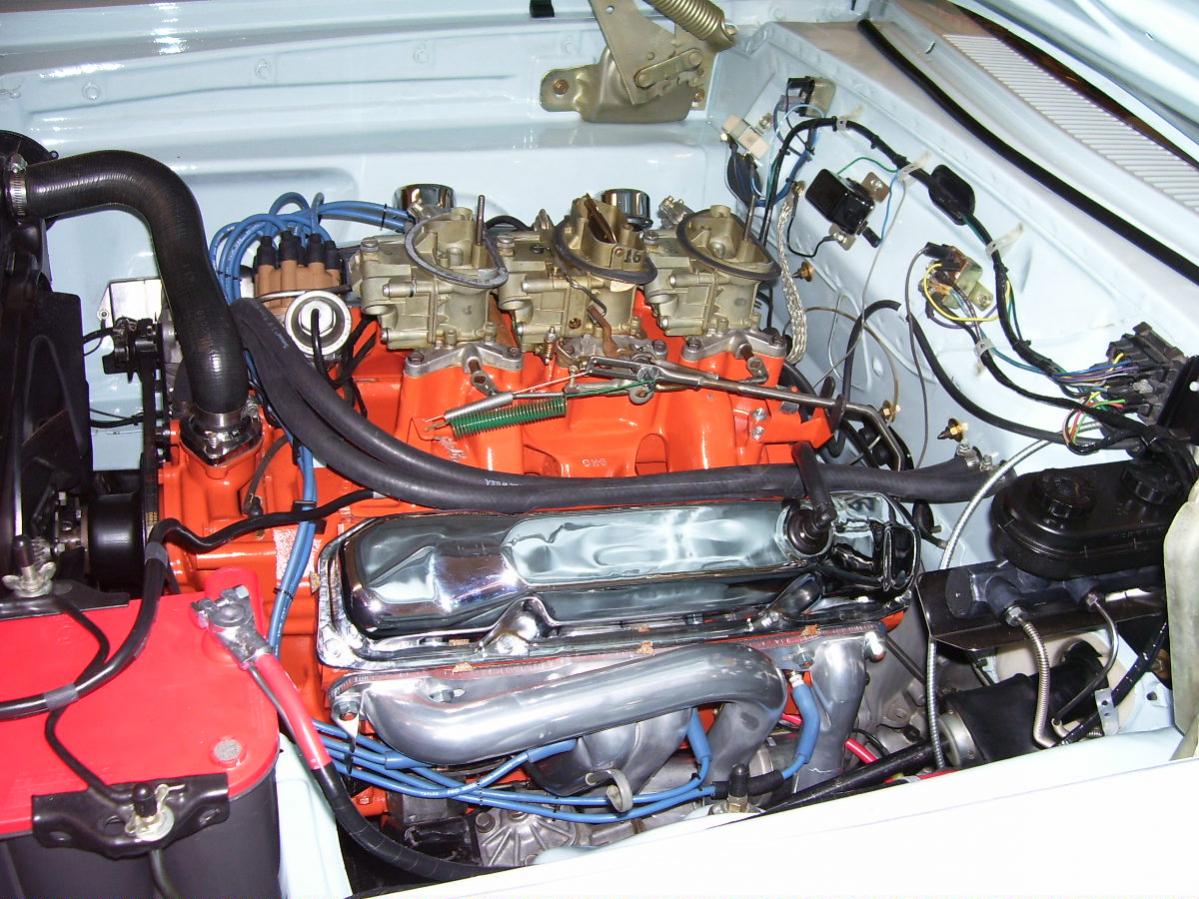

I'm getting ready to redo the plug wires. I purchased a set of MSD 8.5 customs with 90º boots. I also picked up 2 extra 180º boots that I planned on using with the #5 and #6 cylinders. I was wondering if anyone had pics on how they ran the wires around headers and what boots (90º or 180º) were used. Any tips would be appreciated too. Thanks!
90's 0n 1-3-2-4-8. straight on 5 & 6. 45 on7. tti 2" headers.
You may want to consider running the insulated boot/plug covers. Not rel pretty but they really workhttp://www.advancespeedshop.com/protectaboot-black-pack-010511-p-10904.html
