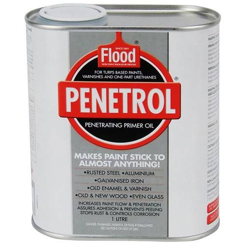

If I can't access an area properly I still try to get as much surface rust off as I can, then spray or brush a mixture of Ankor Wax and Penetrol to encapsulate it. There was article in a UK Classic Car magazine some time ago and they tested a load of different products and this mixture came out the best. I'm not sure if both products are readily available in the US. The Ankor Wax is used a lot by the VW Kombi Owners, it can be used on the sheetmetal too to preserve a rusty patina that's the current trend. The whole underside of my Plymouth and inside all the panels is now sprayed liberally with the stuff. I'd be hesitant about painting anything over it - I'd rather still be able to see it (you can see the areas sprayed as they look like waxed rust, which they essentially are) and monitor it annually. I'm always jealous of the guys who have the skills/$$ to do a complete rotisserie job on the body, but if all you want is a reliable cruiser then encapsulation is fine I reckon.
