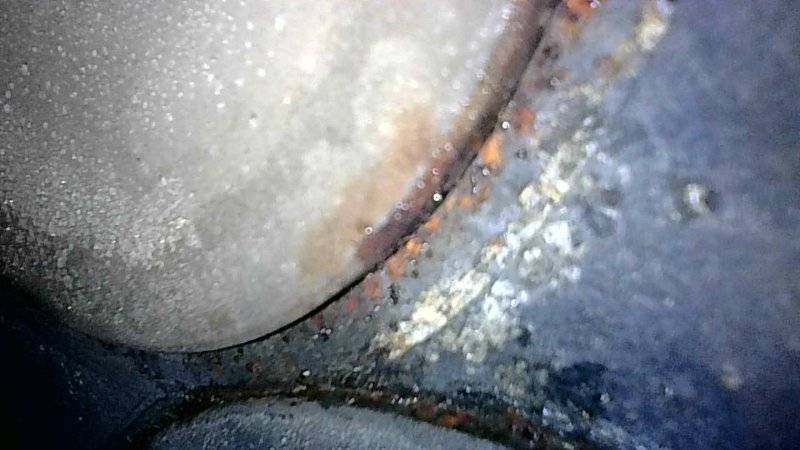

I stuck a camera in the cylinder and found rust on the exhaust valve3 on #8

Yep, my bad, the valve seat is rusty, not the valve.

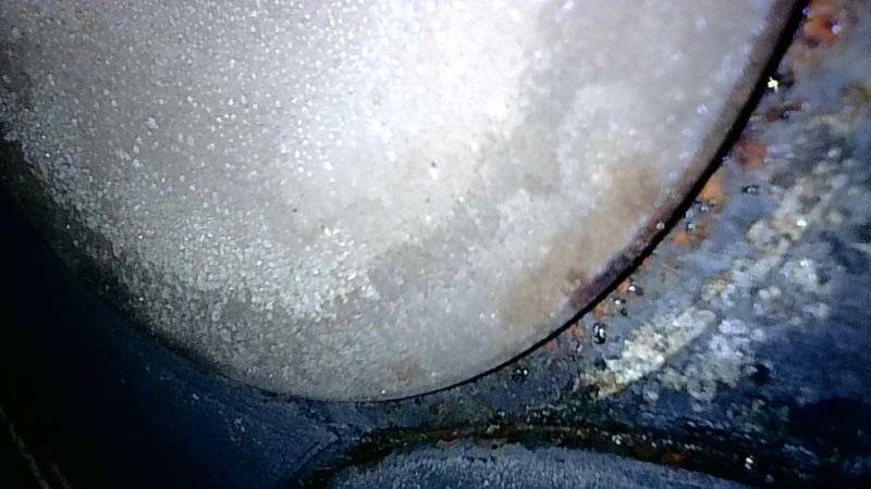

Here's a couple pics of the valve seat

You are good on the bolt torque. I looked up a Pro series kit. If you take the heads off (recommended), you will need some more ARP assy lube. You could have a coolant leak from an exhaust manifold fastener, and it is going into the exhaust port. Head are going to have to come off for a valve job and mill (done properly for aluminum!!) as a minimum.
Its most likely from condensation. However that exhaust valve looks to be burnt.

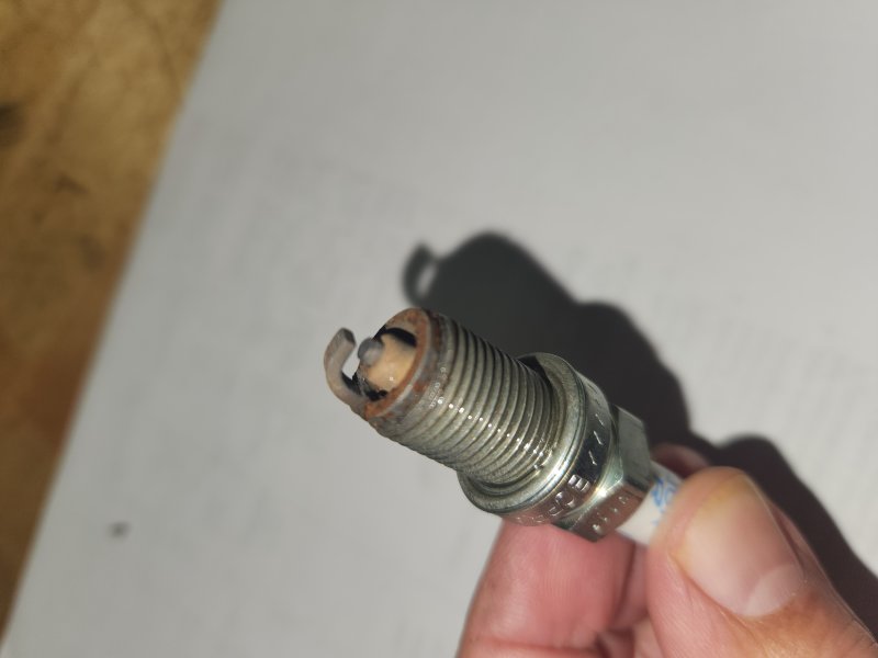

The plugs look a little crusty as well around the end of the threads but the electrode and insulator look fine. I post some pics of those as well.

Here's a look at the plug from #8
Looks to have the same rust/deposits on it

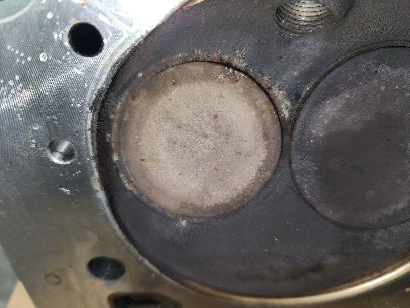

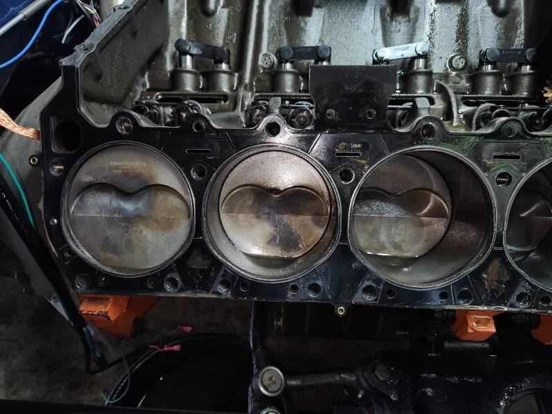

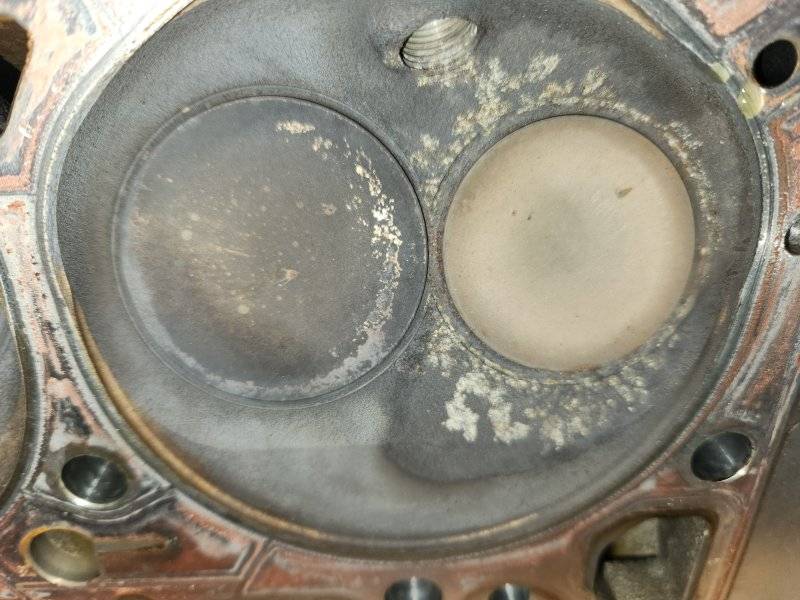

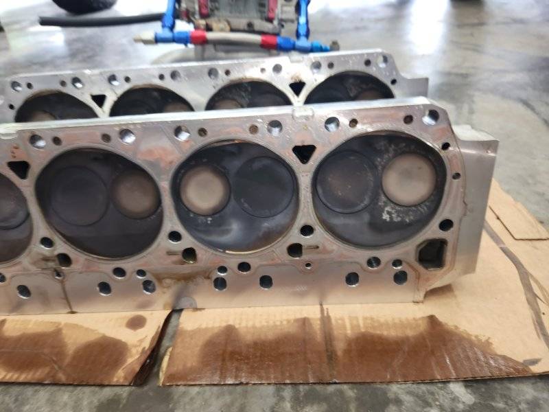

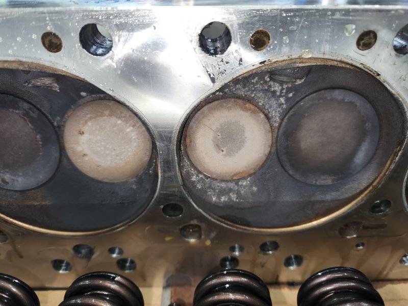

Heads off. Gaskets look good but is this detination damage? It's not pitted, just marked up
