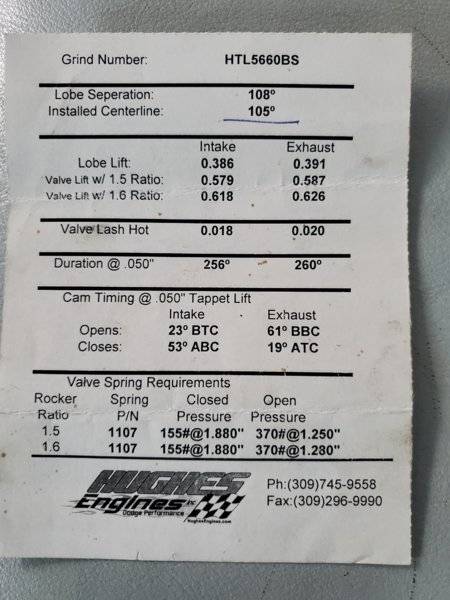

This is my cam. Timing is already pretty tame. 36 total with the lighter springs so it comes in pretty late.
Actually I think the lite springs make the timing advance sooner. Looking at the timing lite will tell you. Back the timing down to 34*, see if that works. Otherwise you're stuck with mixing fuel, or thicker head gaskets, swapping pistons. Depending on what ignition setup you have. Some ignition tinkering may help.

A hughes cam with a lsa on 108 with a steep ramp is building compression and not helping, It looks like that is a older hughes so it's hard to say what seat timing is as Hughes doesnt consider seat timing important. But since Hughes uses Howard's cam profile's your current cam has been replaced and is listed as 284/288 @ .020 lift. It's a good sized cam at.050 and is going to make power, but Imo...not a pump gas cam at 10.5 ...my guess is it will struggle to run on pump gas until scr is below 10:1. A different cam with a wide lsa and more seat timing is needed for your present compression, but there are to many details missing in the build to really say what all is going on. Too hot of plugs can even cause a engine to detonate. It's often overlooked but it's the first place to look.
What plugs? Is the ping on tip in only or all the time? Try slowing the timing curve. Tighten the lash .004". Next back the cam off to 108 if its really in at 105. To be honest true 10.8 with a Eddy head should fly. What is the cranking compression?

why not try retarding the cam? would this not bleed off some compression due to intake closing later on the compression stroke?

6) back the cam up to 108 like mentioned,
7) tighten the intake lash up 0.005" (cold lash setting of 0.006"-0.007")
