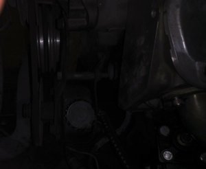

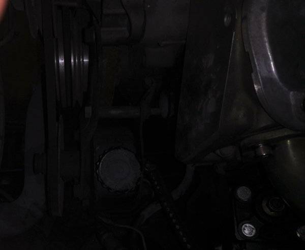

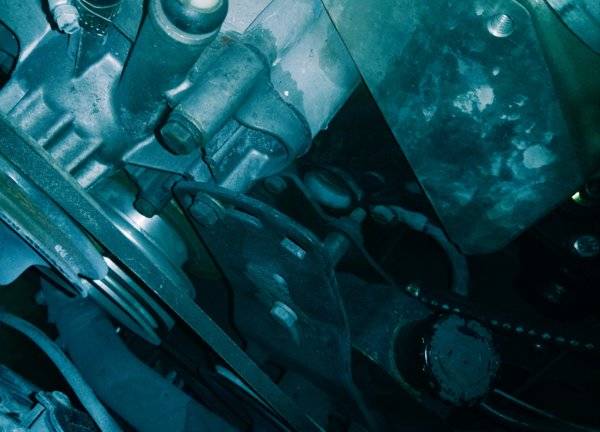

Have any of you guys mounted a Saginaw power steering pump on an early 318/340/360 with a steel water pump? I have been searching the net with no luck. I want to get the borgeson pump and bracket, but I read somewhere that those are only for later small block engines with the aluminum water pump.
Any pics and/or recommendations would be appreciated.
Thanks in advance!!!
I will get some pics this weekend. I have a Saginaw pump on my 69 340.
Second call... Does anyone have pics of a Saginaw pump on a early small block with an iron water pump?
Thanks!
Sorry for delay. Hope this helps.

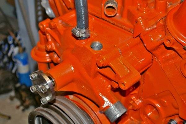

I believe this is the style of water pump that he has. (It's cast iron, not the later cast aluminum).
