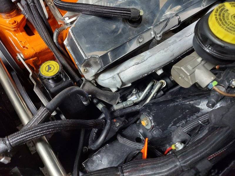

I tried the "pump it down" article for the saginaw pump. The shim idea that richard ehrenberg put out. I had bought a new saginaw pump, new borgeson gearbox, cooler, the upgraded linkage, etc. All of that have been working just fine, but still feel like the over powered factory gear box. No slop, just over boosted. Can turn with one pinky finger. I tried the shim idea this weekend, emptied tank, added shim, bleed the system and it really didn't help. Maybe a little?? Either way, now the saginaw makes a whine. The more rpm, the louder the whine. I can't rev engine over 3500 without the pump sounding like its ready to go out. I only added the about .07 "shim. Any advice? Do I need a different model saginaw?

When hydraulic pumps whine, often it's from an air leak. Does the fluid look like it's foamy?
0.07" shim? That is very thick. When you add shims, you reduce pressure. The opposite of what you would expect. Rarely to these pumps need to be modified. While the pressure is regulated by the above valve, the flow volume is regulated by the size of the hole in the pressure hose exit fitting in the bottom of the pump.
