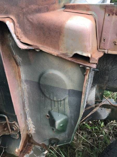

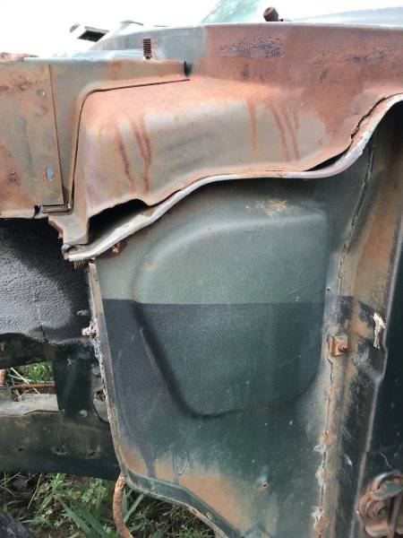

If you need a pics on how big the drains are, I can post them as my front fenders are still off the car.....
I would like to know out of a sense of curiosity. I’ve spent a lot of time under there but never noticed them. A picture would help. Thanks
Maybe this helps, you 'll probable need to remove the rear splash shields to see them.
