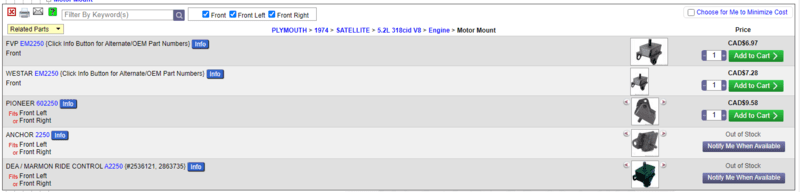

Rock Auto shows these.
Do they look correct?
Yes, get the urethane inserts. They work great.
Not really hard to install, the hardest part is getting all of the old rubber out of your original mounts. As I mentioned before, you may have to cut, press, or even burn the old ones out. Once you have cleaned out the metal pieces as best you can, you should be able to put the urethane inserts in with little effort.
