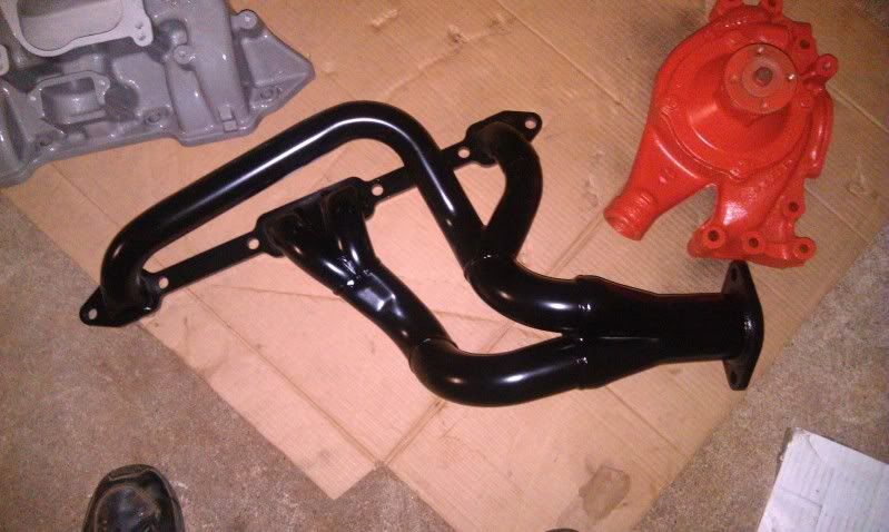

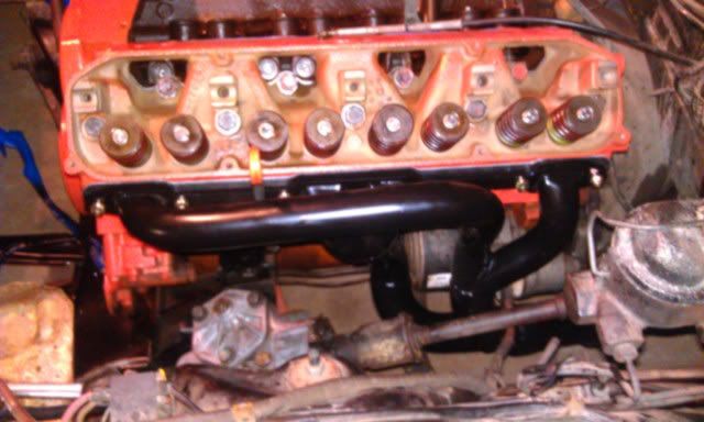

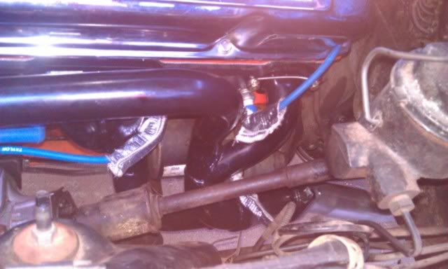

I recently put a set of them on my 71 Charger and they are snug. I've also had a set on my 71 Duster with 440 a couple years back. I went with them due to ground clearence. I hate scraping and banging heads on speed bumps and the like, so I went with a set of Schumaker's. I get them bare steal and had them powder coated black. They look great but I found that it indeed captured my standard starter after all. They claim that it doesn't but there is now way to get that baby out without some sort of mod. I cheated and removed the lower mounting stud with a bolt and now can wiggle it out, but still really tight. Here are some pics.
Also, the are a few spots that get really close to the spark plug wires, so I used DEI shielding to protect the spark plug boots, just for extra protection.
Love the sound of open headers...
I used the Schumachers and loved them. Yes, they capture the big starter a bit, but ended up putting in a mini, and fit very nice. Great power too! I plan on using them in my Demon with a 451, dont want to cut or drag and like the extra clearence, especially for the plugs. Would post all pictures but seems they are too big
