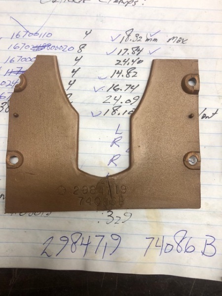

Can someone please post a photo or advise what these 4 screws are supposed to look like? They hold the plastic cover on under the steering column and attach to the bottom of the dashboard. Im not sure whether they are supposed to be chrome or black painted. Part number 2984719. Thank You.
This is the cover

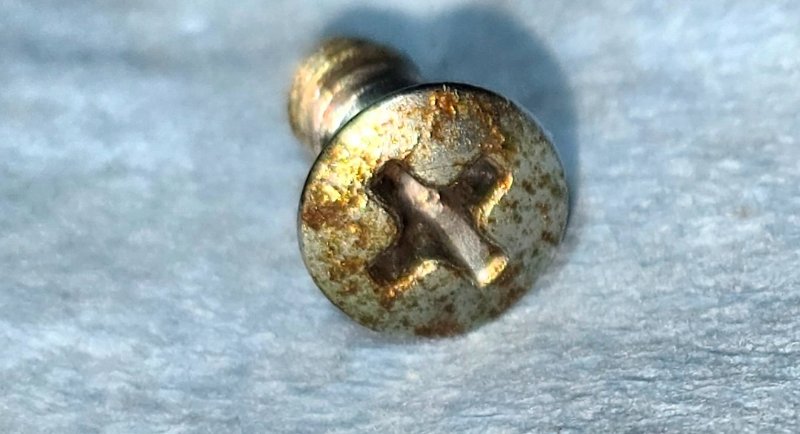

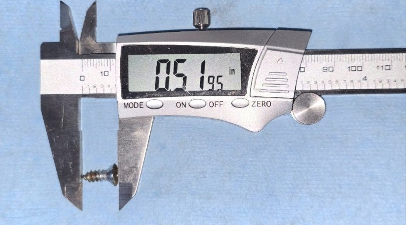

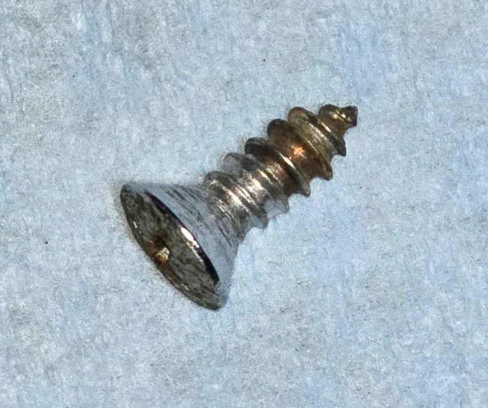

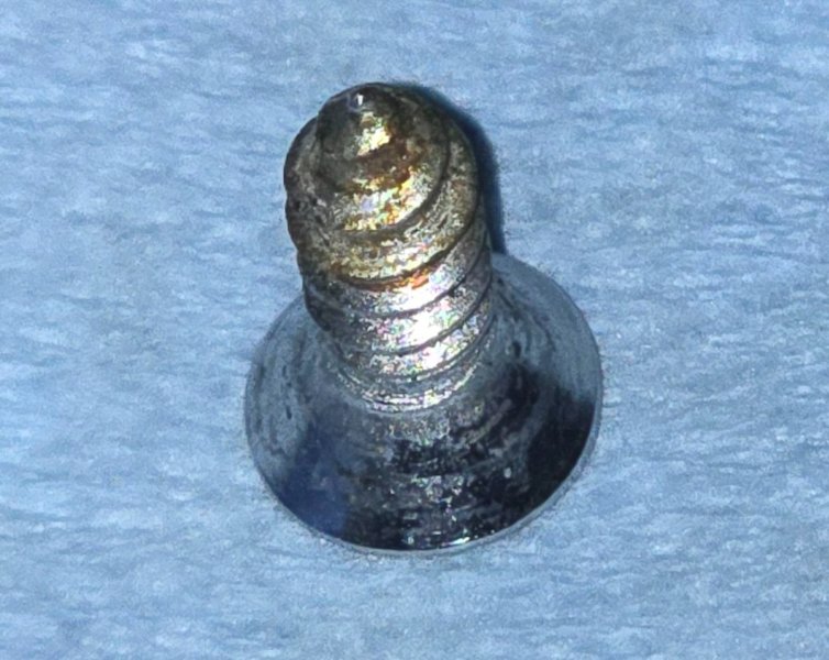

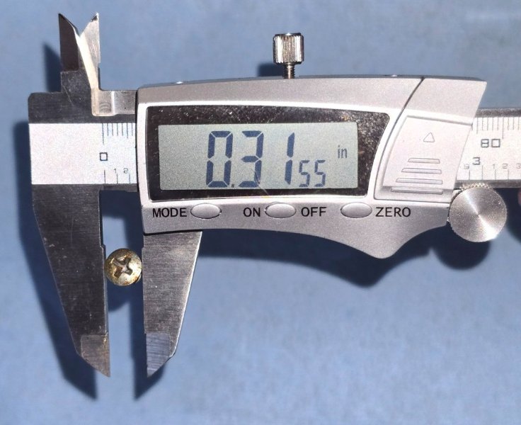

64 to 70. Five of my cars have stainless/chrome, the Bee has Black... probably because I used part of a trim screw kit on it.
