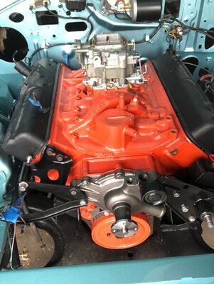

A complete rebuild was done on my Poly 4 years ago. Engine sat since then, no fluids. Recently turned it over a couple times by hand, no problems. I’m getting ready to fire it up. Would like to put something in the top of the cylinders for a little lubrication prior. Have read about Sea Foam, Marvel and an ATF concoction. Again, nothing to ‘unstick’ just looking for personal preferences on a little top end lubrication.
