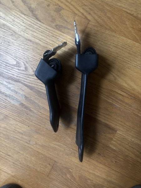

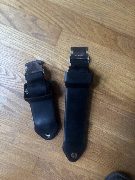

I have both types here. 1966 Belvedere II or Coronet I suppose, 2 door bench seat. Tall and short, no interior in car when I bought it so which one if you have an original?
I'm gonna go with the one on the right, but neither of my '69's have the correct belts.
66-67 b bodies use short. C bodies are long. They look the same, just longer.

I picked the short ones up yesterday at healer show at MIR for $20

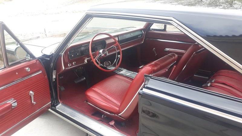

The ones in my 66 are like the ones on the right, and they are molded red, so I can only think / hope they are the originals to the car

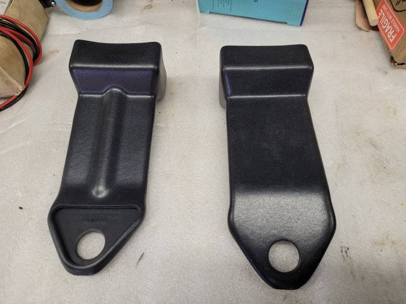

Look at the side view. The shorts have angled top, the long have a straight top. 67's have the short with angled tops that I have seen and owned. Bench and buckets have the same belts.

I have some short ones with straight tops but are light blue I can paint black. The angled ones do say 67

I have the same red interior on my 66 Charger GTX 6970. Same boots and the car was in the same family since new. No doubt yours are original or the original type.
