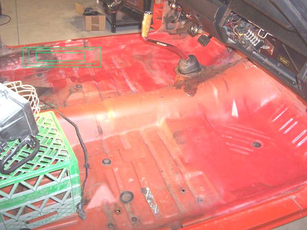

can anyone help me with the seat belt hole locations on a 69 gtx. when i was restoring i couldnt find any and it didnt look to me that the floors were replaced but maybe they were so now i guess i have to drill? o and its a bucket car. thanks

Do NOT drill new holes. The front belt hole is along the side of each floor. They are a threaded hole. See pic for general location.
ok thanks for the pic warwagon i still need to find the inner ones becouse it is a bucket seat car but they should be directly accross from the one in your picture at least i think so. was there such a thing as seat belt delete cars then?
No belt deletes.
The other front holes are along the sides of the tunnel, towards the back.
They are threaded holes also.
