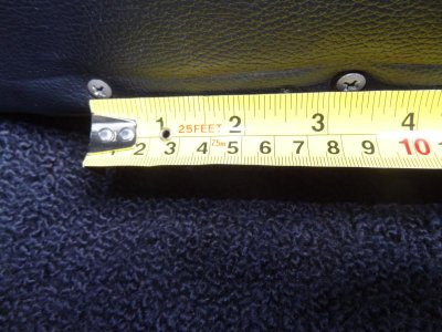

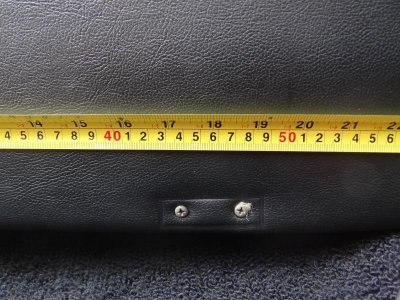

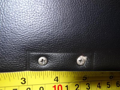

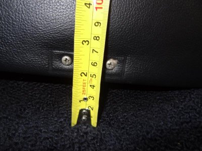

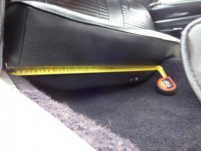

OK, so I did some quick measurements and took some pictures. This is in my 1970 super bee so hope it helps. Passenger side from edge of seat to leading edge of first screw is a hair longer than 17 1/4 inches. Outside screw to outside screw passenger side about 1 7/8 inches. This is the side where small clip goes. From bottom of seat to bottom of screws roughly 5/8 inch. Drivers side where the bigger clip goes, from outside of seat to leading DSC00731.jpgDSC00732.jpgDSC00733.jpgDSC00734.jpgDSC00735.jpgDSC00736.jpgDSC00739.jpgDSC00740.jpgedge of first screw 18 3/4 inches. From outside screw to outside screw 3 1/2 inches and again from bottom of seat to bottom of screws 5/8 inch. All measurements are basic and I have attached the following photos. I hope this helps out and thanks to all that have helped me out.
