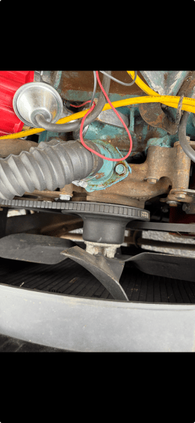

How would you handle this? I’m thinking of a 2 groove pulley and put the power steering on the outside groove and I’m going to have to get a new belt.
Worried about it rubbing on the pulley? Don't.
That's exactly what I was worried about. The original engine was at sometime replaced with another 383 and I was thinking they just maybe used the wrong pulley or put it together wrong.
Belt is possibly too short .. can't tell on that tight shot, putting the p/s pump pulley to far up.
You can't run a double pulley as the alternator/water pump belt and p/s pump drive pulleys are different sizes and belt speeds don't match.

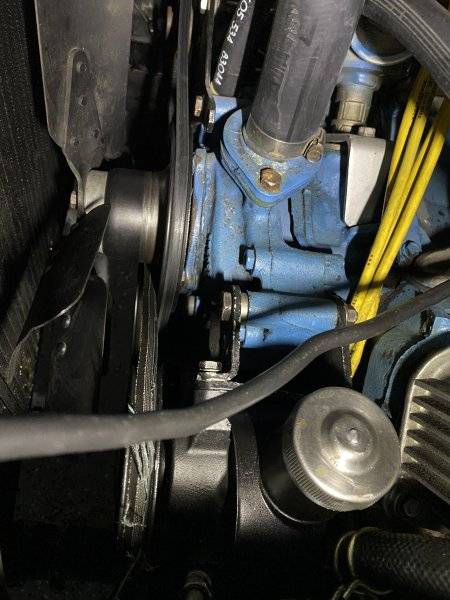

So I would have to match all three if I wanted to change the pulley? I’ve seen kits for that…..but $$$$$$. Here’s another shot, don’t know if it shows a little better.
No you need to show where the adjustment slot in your Power Steering pump is at. If it's all the way "up" and belt too short then your P/S pulley is high enough to make it rub the water pump pulley. Longer belt = lower P/S pump in my mind anyhow... and there's not much left there today!
Thanks, I will look into getting another belt. I have no idea what this guy did certainly cant ask him.
