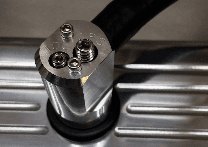

Anyone ever use one of these adjustable pcvs?
http://mewagner.com/?p=444
That's some fancy stuff right thar!
