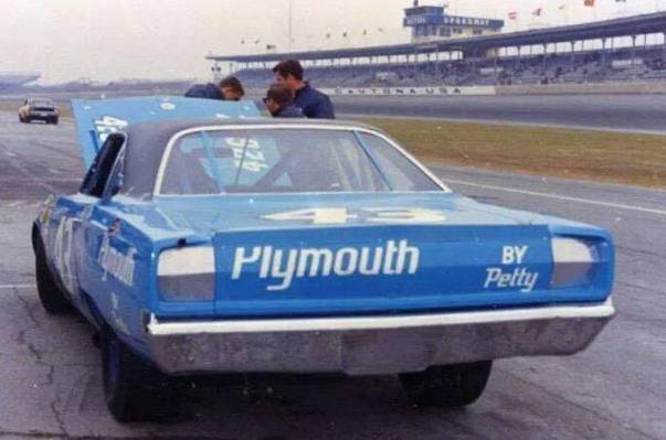

Anybody notice the small lip spoiler on the trunk lid??

I don't have a 68 to compare to, but the rear bumper's ends are definitely "tucked"?

I don't think that's a stock rear window. Something is going on around there. I think the dutchman panel is reworked too.
The black top paint being extended past the window is to throw your eye off. The whole area between the 1/4 window and rear window may be shortened and/or reworked.
The underside aero is like what the Smokey Yunick 66 Chevelle has.

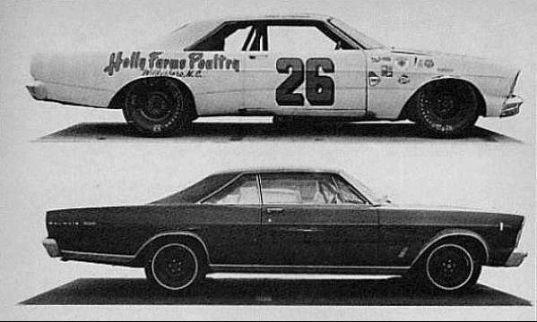

The whole body from the side looks rotated to move the front down and the rear up in the air to catch downforce. Similar idea to get the rear up like Ford did with the 66 "banana" cars
I agree, I thought the rear windows were slightly concave, not sure. Could it be a stock window glass that was reversed/flipped?

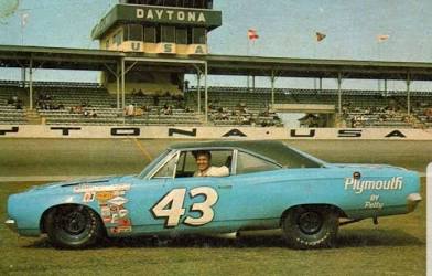

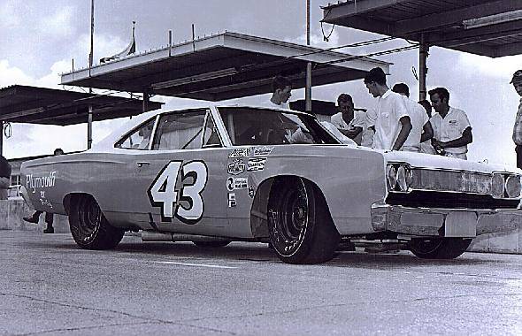

Anyone notice the front bumper is pulled forward to get more air over the car?
The extreme rake gets laminar air flow over the roof and backlight cutting drag.
Almost looks like the front frame rails are bent up to get rake and keep the suspension where they want it?
I submit that raked brick had zero laminar air on any exterior surface other than maybe a slice on the upper part of windshield.
Did the extreme rake calm the aero down, yes IMO.
