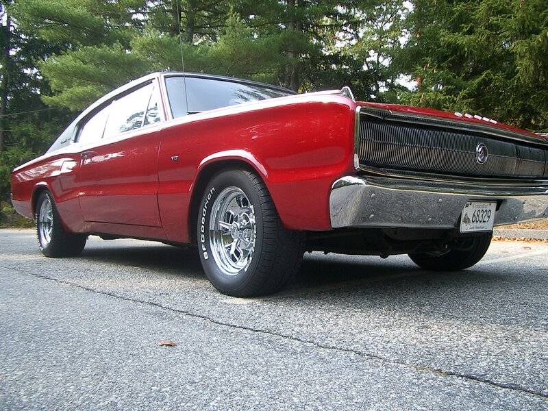

1967 L code Dodge Charger with 4-speed transmission. Picture taken by previous owner in the fall of 2019 and one of several included in the sale ad.
Some of you may recognize this picture if you, as I do, routinely peruse car ads on eBay.
My first reaction to the picture was: In 35 years of looking, I’ve never ever seen a red 67 Dodge Charger with a white vinyl top. Now, I have never been a fan of vinyl tops on cars and seeing a red car with a white vinyl top confirms my dislike. A black vinyl may have been slightly better looking, but the red body and white top just doesn’t look right. To me, that red car would be much better looking without vinyl.

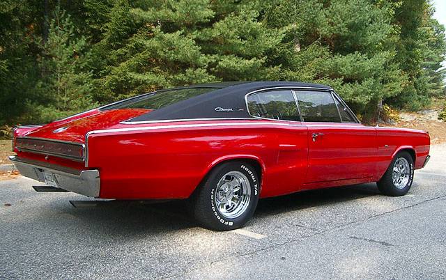

Same 1967 L–code Dodge Charger with 4-speed manual. Picture by new owner in VA
The most obvious difference between the two pictures is the wheel treatment…one has wheel covers and the other hubcaps. Which is factory correct? It’s the bottom picture and I know because documentation tells the tale. Here is a portion of the car’s buildsheet.
Cars with wheel covers came with black wheels, cars with hubcaps were painted to match the body color. P(red car) = P-red wheels and # 07 under wheel covers=2768007 hub cap.
The standard (no option specified) wheel treatment for the 1967 Dodge Charger was a set of 2768007 hubcaps. The 1966 Charger was different…it came standard with a set of attractive deep-dish spinner covers.

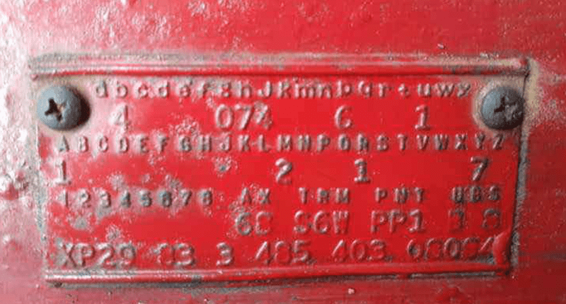

Neither of the above pictures show the correct tires. The buildsheet and fender tag have “485” displayed. “48” is the option code for 7.75 X 14 red streak tires and the “5” indicates a set of 5 tires for the car and these tires were standard equipment when ordering an L or J code engine Charger. I can only imagine the owner disliking the appearance of his new Charger as built and decided to add the non-spinner deep-dish optional wheel covers as an afterthought.

Fender tag from the above car showing, for one thing, an unusual absence of either a console or center arm-rest “mother-in-law” seat option. The top row of lower case letters: b4= bucket seats. Console cars would have a6 or center seat a5. In my 35 years of early Charger watching, I seen only a couple examples so equipped. Note: the 1966 Charger came factory equipped with center console and no center seat option was available.

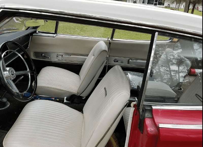

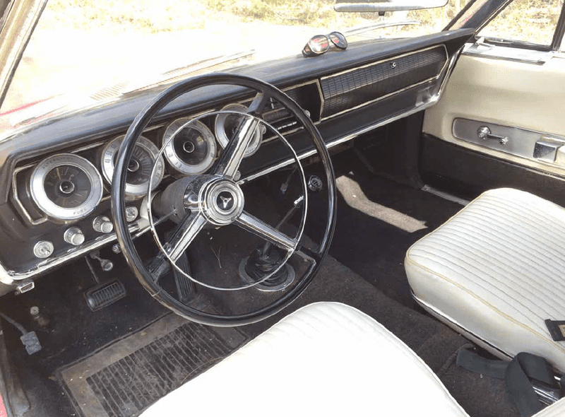

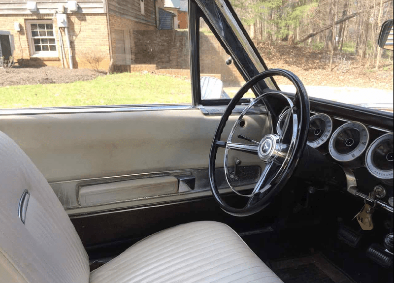

Interior picture showing an absence of either center seat or console. The 53 years old white vinyl bucket seats and black carpet are original to car. Both show signs of some wear, but are not likely to be replaced anytime soon. The original dash pad is crack free however the steering wheel has separation as shown.
All gauges including the tach work and the dash appears never to have been apart. The car has 48,000 miles showing on the odometer and this mileage has been verified to be actual by the wife whose husband ordered the car in 1967. In a future post, I will include some of the correspondence with this lady, like me, now in her mid seventies. I am the second owner of this car.
Notes regarding the interior when I took possession of the car:
1. 4-way flasher not working. Pulled the switch, took it apart, cleaned the contacts and now it works just fine. Remote driver side mirror had been removed and replaced with a cheap aftermarket one. I installed an original factory remote mirror in its place
Look closely at the position of the two passenger side window cranks. With the windows rolled up, they are aligned horizontally with the knob facing rearward. I believe, but sans factual proof, that was the factory setting during assembly. Of the four window handles in the car, three were aligned as shown in picture above. The one crank not aligned like the rest was on the drivers side door and that panel had to be removed to allow the remote mirror to be taken out. Whoever did the work replaced the crank incorrectly.
The one incorrectly aligned window crank shown before I installed the correct remote mirror and realigned the crank. Also note the hole for the remote mirror knob..now nicely filled as original.
