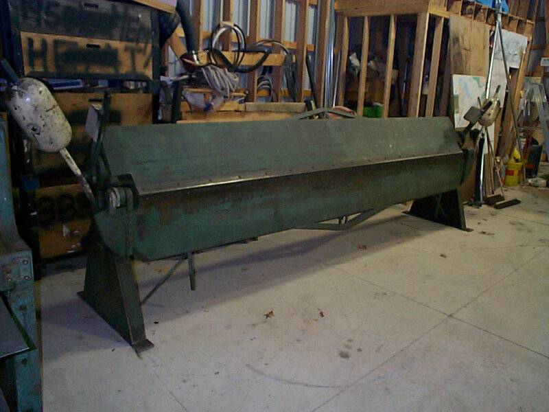

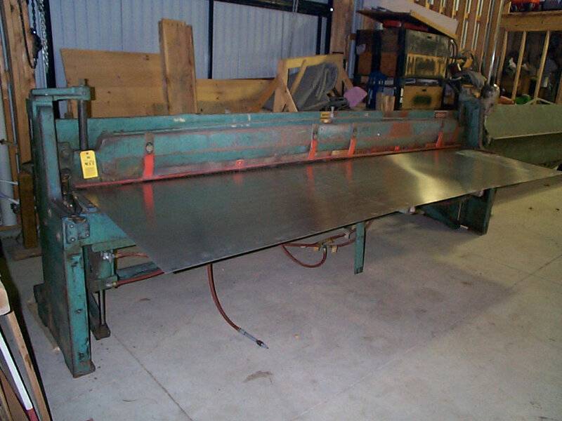

Amazing what you can get for peanuts at a "woodworking" auction! It cost me more for the haul than the brake and shear !
View attachment 1237185 View attachment 1237186
Oh, You Suck!!! LOL!!! Nice!!! Only problem is how much room it takes... But considering what you do you have the space & can really justify having a big piece of equipment like that....
Overkill for bending little patch pieces. Nice old brake though.
Yep, they're out in the hangar for the times I need to slice a 12' sheet lengthwise. I also have a 4' air shear and an 8' brake in the shop... but they're destine for the hangar now as well. Too many cars in the way.. lol
Shear is on an old feed mill cart so I can roll it where I want.
