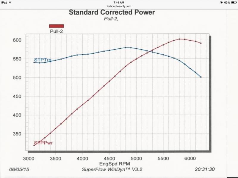

tach 2.jpgIf your dyno sheet shows maximum horsepower, let's say, at 6000RPM should you actually shift at 5800 (or so) so that the shift goes thru at 6000 or should you actually shift at 6000 and then the shift would not complete until about 6200.
(Note: I am not questioning how long it takes your tranny to execute the shift just if you should have the motor shifted into the next gear right at the Max Horsepower RPM OR go past the Max Horsepower RPM and then shift)
In other words, should you run your motor just up to the Max Horsepower RPM and then shift OR should you go OVER the Max Horsepower RPM and then shift.
This is, of course, for the 1-2 shift and the 2-3 shift...nothing to do with high gear.

Shift past peak hp. Ideally you want to shift at a point past peak hp so that when the shift is complete you are at the same hp below peak hp. Ya want to be at the average highest hp through out the run. You have a dyno sheet. With the percentage of rpm drop between gears you can figure mathmatically when to shift. Personally, i shift where it feels fastest.

I'm not a racer, but I've studied this in college and according to my professor, you should start with a shift point that maximizes your area under the horsepower curve. This is really just another way of saying what hangnout said up above. So basically, say your peak is 6000 hp and shifting from 1st to 2nd gear drops your rpm by 800. Then your best ET will be somewhere around a 6400 rpm shift point.
Keep in mind that this technique 'theoretically' maximizes your horsepower at any point on the track but there are a lot of real world issues that need to be accounted for, such as
a! can your engine actually live in that rpm?
b) most hp curves drop off steeply as carb / head max cfm are approached, so this shifts the ideal shift point down.
Mike, take a look at what RPM the peak torque is. Try shifting at the RPM that drops you back to the peak torque RPM. But if the torque curve is really flat (which I think may be the case for you, if I remember your dyno sheet correctly), then go past peak HP to maximize that area under the curve like HT413 said. However keep in mind what your desired max RPM is for durability sake. After doing the benchtop analysis some trial & error testing will let you fine tune the real world conditions.

Because of the converter, i think I have to change my answer. Question for ya, I see you have a 5000 stall converter, but when you make the 1-2 shift, what is the actual rpm that motor settles into in 2nd gear?
Also, i saw in your motor thread that were shifting at 6200, is that where the motor really shifted, or was that where you shifted and the motor wound past it by a few hundred rpm?
Because the converter keeps the motor at that stall rpm (until you basically exceed the stall), shifting at the hp peak will just drop it into the stall rpm and the converter does the rest. So i think converter stall has a lot more to do with how much hp you are putting to the ground down the track than shift point. So basically, after fooling with the shift point and maximizing your ET, i think tuning your converter to settle into just the right rpm would have a greater effect, since you are into the stall for far greater time than out of it.
ideally i think you want to stay around the peak torque rpm when up shifting and rpms drop. don't confuse engine dyno peak horsepower with peak horsepower that the chassis sees. back in the day the used to say shift at 10% above peak horsepower rpm. i think that's way too high. in reality only track testing will give the true answer. with an automatic trans i've tried doing the 1-2 shift at a little higher rpm than the 2-3. i've done this because the gear spread of 1 and 2 is greater than 2 and 3.

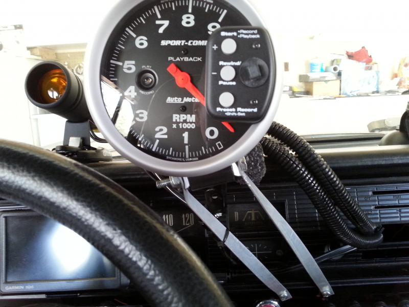

Have you tried in car video to see what is happening on your tacho , I see you have a read back unit .?

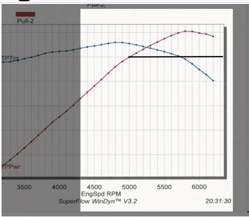

A few notes: The engine will always fall back to true stall, or fall back on the shift. This will generally be 300 rpm or so higher than converter flash. Best ET will be when the shift is made right at the peak G-force . This is usually accomplished by shifting past peak HP rpm. A graph line drawn through the fall back rpm point and shift rpm point on a graph should be level. If the line tips down towards shift rpm point, the shift is to high. If the line tips down towards the flash/fall back the shift was to low. Higher torque engines will be less sensitive to shift points.

I rarely use the tach when racing. I look at it on the starting line when I come up on the converter some and I look at it in the traps. But I shift by the feel of the eng as I always have and I have had good results driving like that. It seems easy to me to drive like that as I can tell when the eng is peaking and I should shift. Sometimes I will try it sooner or higher but it seems to run the best by shifting like I always do. Ron
