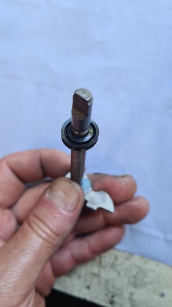

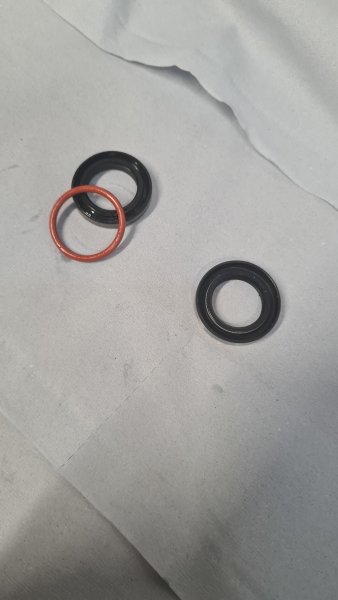

Hi all, out of curiosity... I'm replacing the shift shaft seal (which was completely loose) and I noticed there was an o-ring under it?
Any idea why?
Maybe it was in the seal for some reason?
Sounds a bit weird...
Thanks.

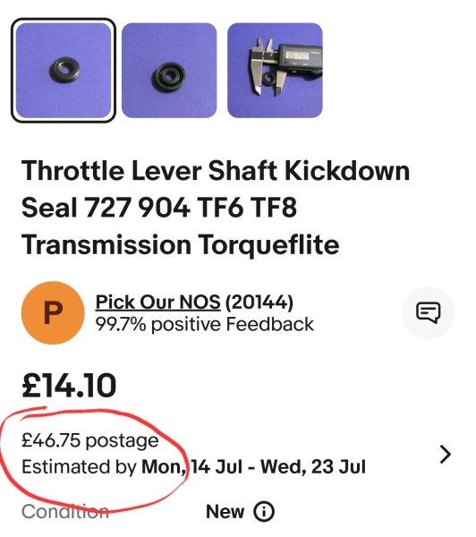

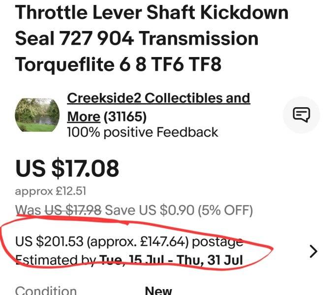

Unfortunately not, couldn't find it anywhere in the UK, Rockauto (which is the best place for us) don't have the item and ebay postage prices are a joke.

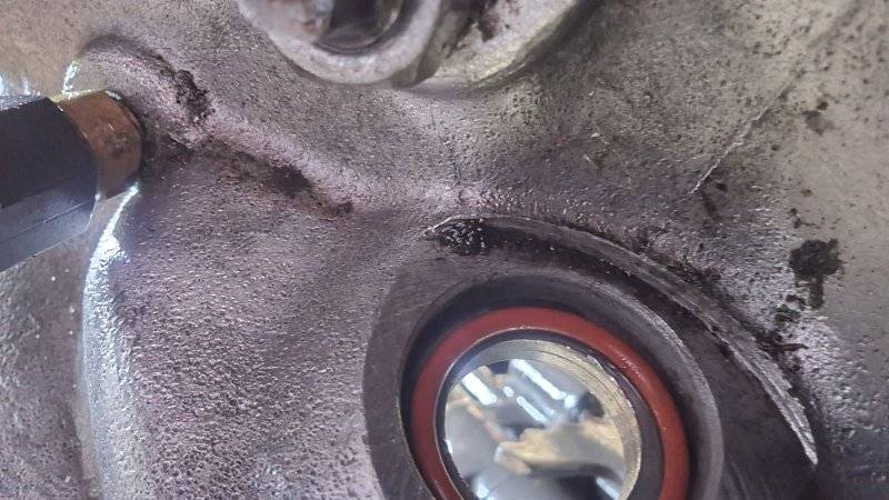

All sorted!
Seal received (bought 4) and replaced.

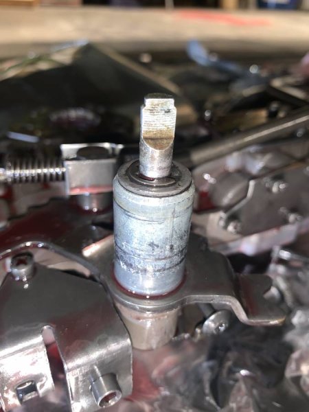

Same as the shift shaft, something was wrong with this one... it was upside down (photo of how it was installed originally)
Thank you all once again.

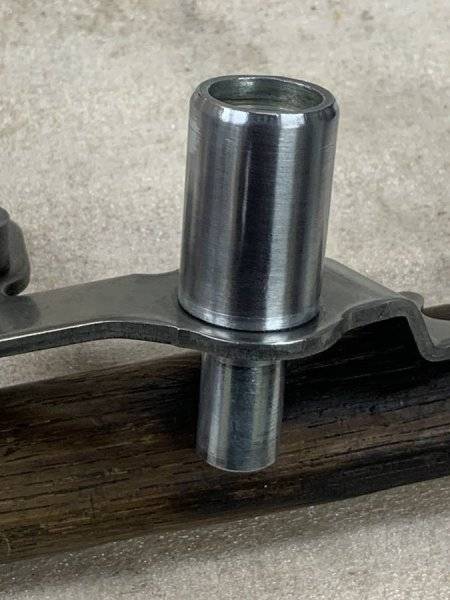

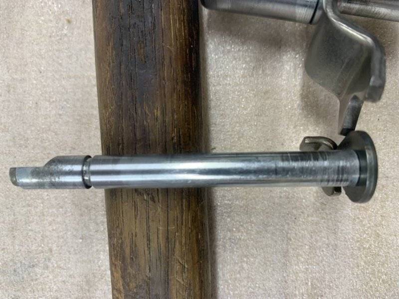

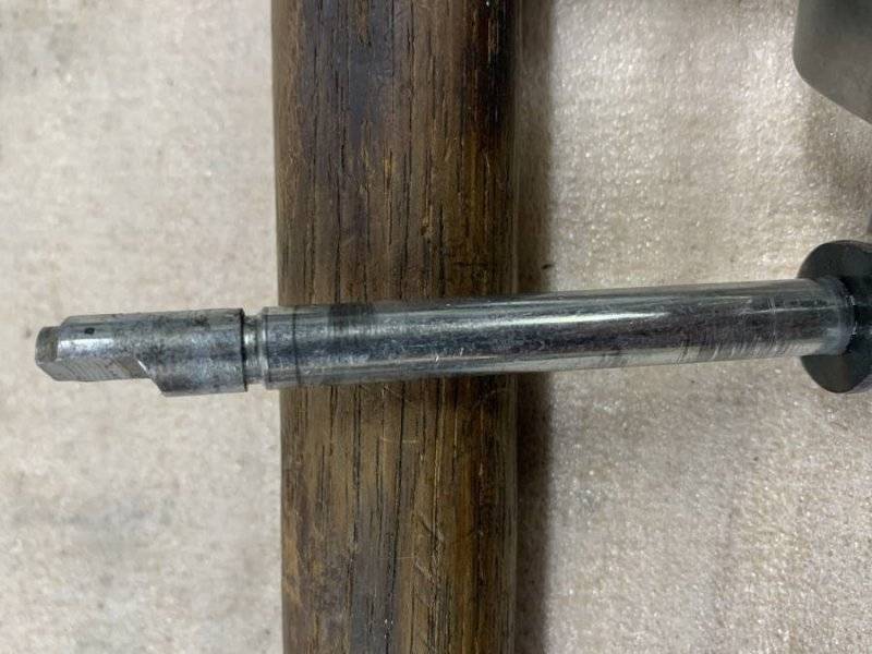

Nice to do: Make sure the shaft area where the seal rides are smooth. I used a dur-burring wheel to polish mine.
