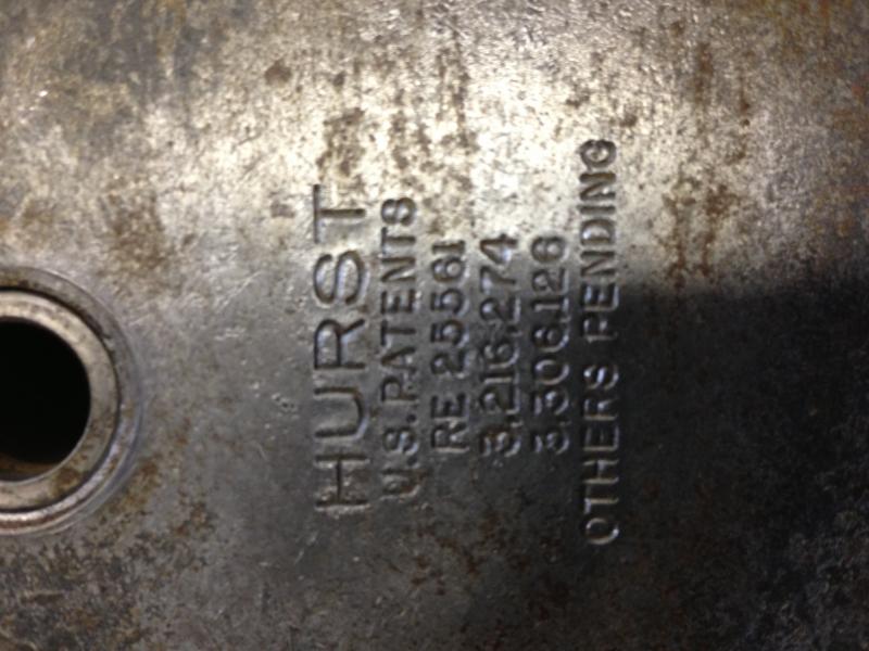

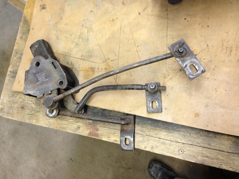

No id numbers on any of theshifter arm Levers. Will this work in a 68 b body?
yes...and you might also need the triangle piece to hold it to the trans if I remember...my Inlands do
By any chance do you know if the shifter mechanism would work for a 70 e body? Are they all the same. Love the pistol grip shifter but dont wanna spend the money on parts i dont need. Thank you
main mechanism is the same, the rods & levers are different for "E" body

That is Not a B/body Pistol grip shifter. Maybe E/body ?
That looks like a 70 E-Body mechanism with 70 B-Body linkage rods from what i can see by the pics provided
