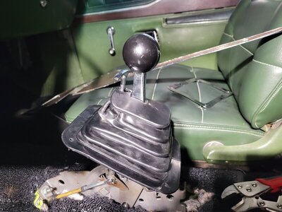

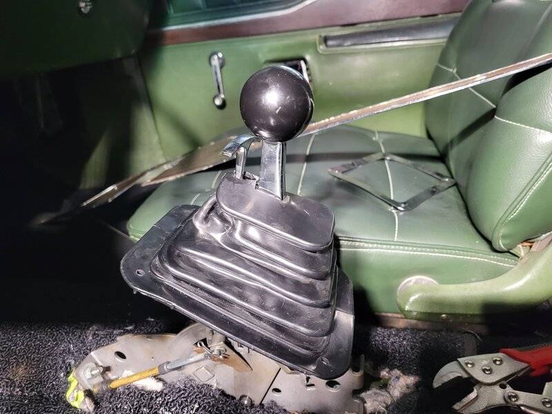

currently have a B & M ratchet shifter, something broke inside, now stuck in 1st gear , any suggestions on replacement?

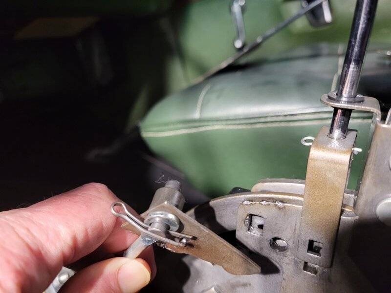

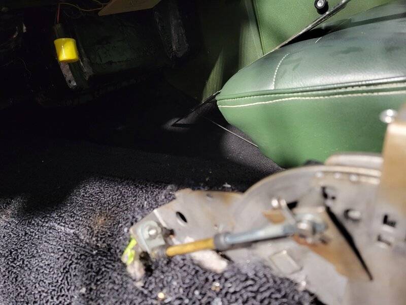

I did pull the cover off, the plate that connects the cable to the shifter is broken cant see how it goes together
this is what broke - suggestions to fix?? would like to " patch it up" till I can do the full slap shift convert, i think the 3 little tack weld broke ??
I lied, its a TC shifter
Okay. THATS why I didn't recognize it! Pop it out of the car, and get it welded back up. Make sure the cable isn't hooked up when welding, and also make sure the cable works freely. Frozen/overheated cable might have caused the weld failure.
