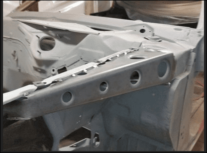

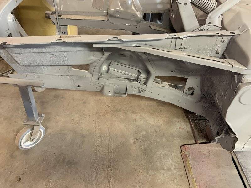

Hello Everyone;
I have to install the inner fender/shock tower strut brace/inner fender to cowl on my 72 GTX. There seems to be a "stacking" order but any online pics are dark or too far away. I want to make sure they are in the correct orientation for mock up prior to welding. I have all the pieces but I would like a better view of the area and welds. Shock towers are there. Thanks for any help.
Hows this?
great pic T2R9 !!!!! Does the cowl to inner fender get spotted to the shock tower brace and then to the inner fender?
OMG! That helps in so may ways; not just the inner fender pieces. Thanks again Guys!!!! You ALWAYS come thru.
