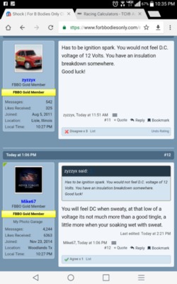

Has to be ignition spark. You would not feel D.C. voltage of 12 Volts. You have an insulation breakdown somewhere.

You will feel DC when sweaty, at that low of a voltage its not much more than a good tingle, a little more when your soaking wet with sweat.
