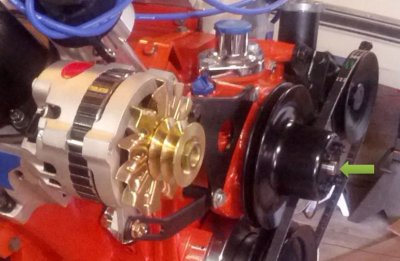

I need about 3/8" more clearance for my electric fan housing to clear, would it be a big deal if I cut the stub end off my Milodon water pump shaft?
If I do that, and replace the bolts sticking out with counter sunk heads that will give me enough room to clear my electric fan housing. I can also trim back the housing a bit to give me some additional clearance.
Thoughts?
yes you can grind it down, but you wont ever go back to a mechanical fan as it uses that extra bit to help center itself.
Or locate a pulley with less offset and push the flange on further then cut end off
you can,just be careful how you cut it.overheat,ruins the seal.too much vib can mess up the bearing.i6206.jpgdid mine with twin fans.goes right between em.
Keep just enough of the stub to fit through the pulley hole to aid in centering the pulley. I like bm02tj's suggestion; the pulley flange might be pressed on a bit further to match a shorter pulley. Of course, every water pump you get in the future will need to be modded in the same way....and the next owner will curse you for using some GD oddball water pump!

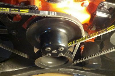

I chopped it and installed countersunk bolts. Turned out great.
Thanks for all the replies and suggestions!
