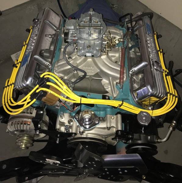

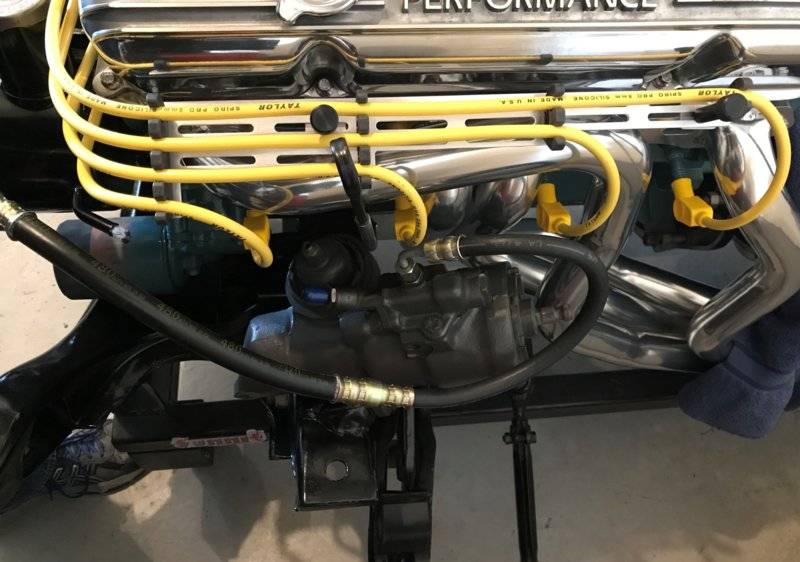

I'm able run Autolite 65's and Taylor wires with 135 degree boots with my TTI
headers. Not sure of the pipe routing of the Summit headers but there are lots of ways to keep from smoking your wires
