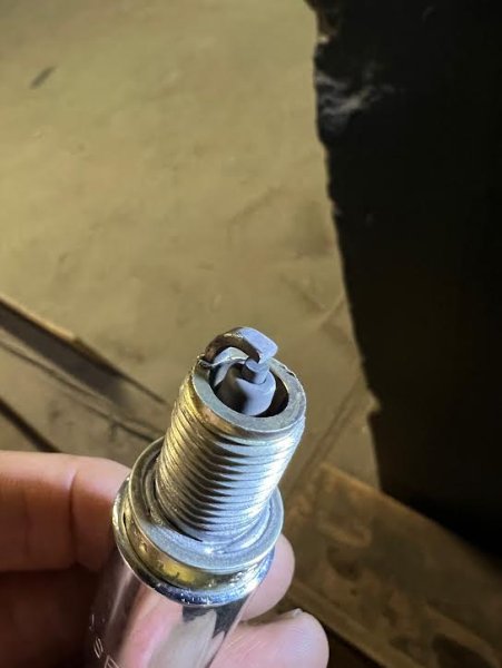

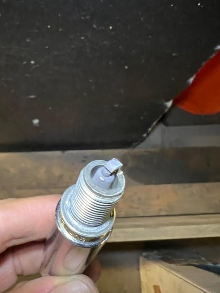

Jets .080 fronts. .094's rear. 6.5 Pv and rear is blocked. All BLP stuff.
Shooters .033's.
Needle seats .120
Idle bleeds .070's all around.
493 cubic inch. 12.5 compression.
I'm gonna full with the mixture screws on the metering blocks and go from there. They are now turned 1.5 out. Might go in 1/4 turn all around and see / feel how it goes.
