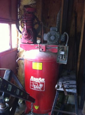

So a guy I know is selling this compressor its an 80 gallon and 5hp I believe and it runs on 220 it is Ram Air brand I believe. He is asking $400.00 for it what do you guys think is that too much I found one on ebay for sale and they were asking $850.00 compressor.jpg
What is the CFM?
That's the key number.
I paid $700 for my 32 CFM unit, and that was a good deal.
That looks like a single stage, try to find a dual stage if you can. it will last longer,run cooler and make air faster. etc.. CFM as stated is very important, try to get the most you can afford. Air compressor is vital tool, go as big as you can $
I couldn't agree more.
